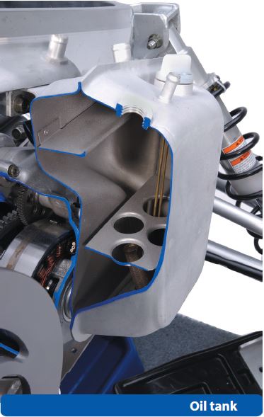

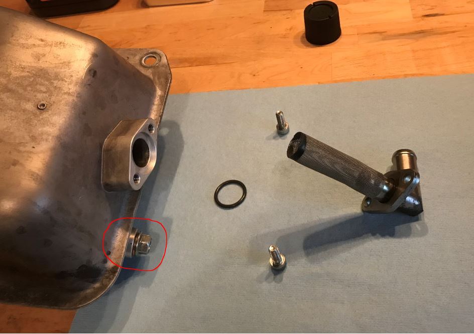

You do realize their is an oil drain plug under the oil tank (next to the pickup screen elbow) AND an oil drain plug under the motor. You do need to drain both as the Apex engine uses a dry sump oil system.
