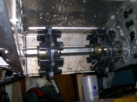

Ice build up also
I put 200mi on in Hurley Saturday and also had a massive build up in my right side panel. Couldn't even get the side cover off untill I took it home and put heater under it to melt ice.
