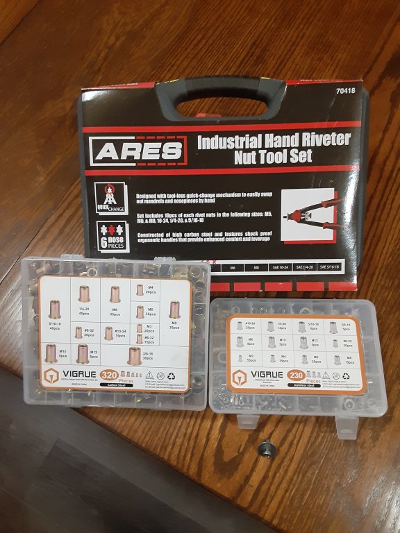

I just did this to my SW and also used M6 button head bolts. I purchased my rivnut tool from Amazon. It is the bigger 2 lever tool.

I uesed 5mm by .75 inch long stainless steel pan head philips drive, bought the tool and rivnuts off amazon, have uesed this tool for many projects, money well spent.What was the exact size that you used? Thread, length, type? Thanks

I bought M5 stainless with T25 button head. T25 is nice as it matches most other screws on the sled
