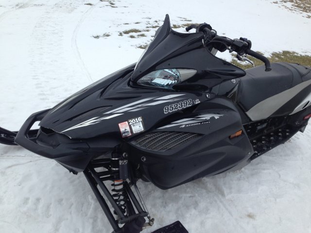

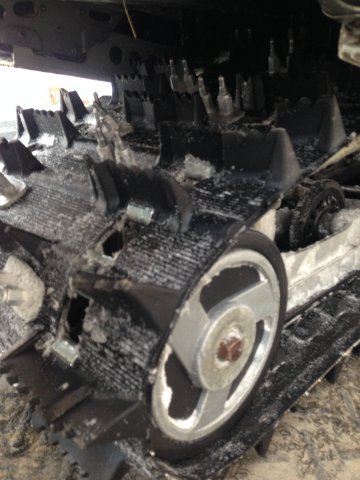

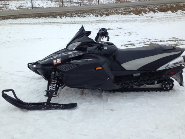

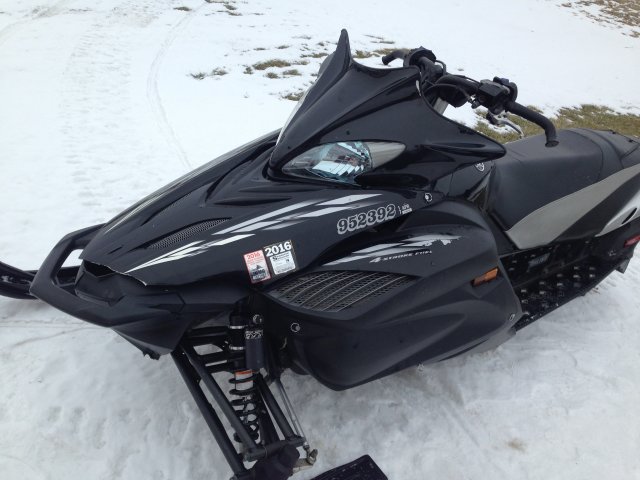

Bpatch50
Very interested in watching your progress. Post lots of pics please!Picked up a parts sled. 2006 Apex GT 121" 17000km
Will be parting out parts I don't need which should hopefully cover most of the price of the sled. Has new 1.5 studded track.
