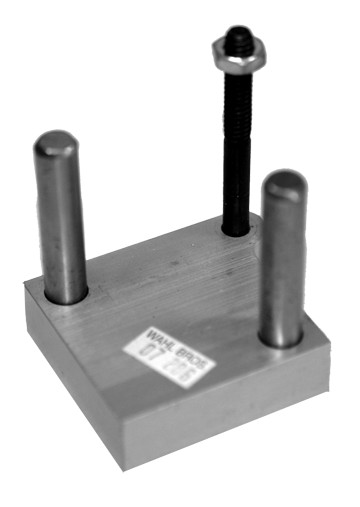

Your belt could be worn and your belt to sheave clearance is out to far. Try running a new belt? The spring is probably not what's causing the jerky engagement. Not saying a soft start spring is a bad idea at all. The notched clutch weights can be sanded down as long as you get them into a holder and squared off.. So they get sanded evenly across all the weights surface at the same time. I like to do this with the linked product below. The weights on the Yamaha clutches do not touch the rollers when full open so this is normal. Start with cleaning the clutches and making sure the rollers are not flat spotted and spin freely.. Try new belt if belt is old? and then either buy new weights or sand the notches out of them.
Ramp Grinding Block – Wahl Bros Racing
wahlracing.com

Thanks for the info. The rollers seem to be in really good shape as the clutches as a whole. Sled only has 1400 miles and has never seen any hard riding in the mountains.Your belt could be worn and your belt to sheave clearance is out to far. Try running a new belt? The spring is probably not what's causing the jerky engagement. Not saying a soft start spring is a bad idea at all. The notched clutch weights can be sanded down as long as you get them into a holder and squared off.. So they get sanded evenly across all the weights surface at the same time. I like to do this with the linked product below. The rollers on the Yamaha clutches do not touch the rollers when full open so this is normal. Start with cleaning the clutches and making sure the rollers are not flat spotted and spin freely.. Try new belt if belt is old? and then either buy new weights or sand the notches out of them.
wahlracing.com
I do have a new belt im putting on. Im also waiting for a BOP secondary adjuster so Ill be able to keep the belt just perfect..
I will pin all three weights together and sand the bumps out..

I did a light and careful sanding on the belt sander, cleaned the clutch as good as I could, wasnt very dirty at all.
got it back together and went for a short rip last evening. Much smoother engagement. I did put a new belt on too, will get the # and post.... Still engaging at 3600-3700, but seems to be smoother. Cant wait for the soft start spring.Going for a longer run today. Thanks for the tips all...
