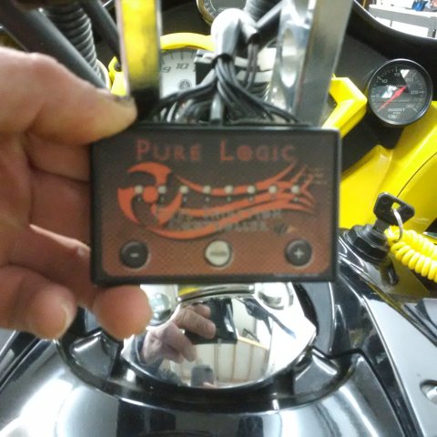

Can you post a picture of the Pure Logic controller?
Here you go

The box has three interactive buttons that are used to enter the adjusting mode and change the on-board tuning features’ light settings. When power is applied to the unit (machine running) the adjusting mode may be accessed at any time by pressing the Mode button. The adjusting mode is distinguishable by at least one or more LEDs flashing. The current adjust mode is determined by the color of the flashing LED(s) and whether or not the 8th LED is blinking blue. The adjusting mode is exited by waiting several seconds without pressing any buttons. Upon exiting, the light setting is automatically saved for each individual mode.
The light settings in each mode are adjusted by pressing the (+) and (-) buttons located on the right and left side of the mode button, respectively. For easy reference, the LEDs are numbered 1 through 8. However, the LEDs can be adjusted to the following positions: 0.5, 1, 1.5, 2, 2.5, 3, 3.5, 4, 4.5, 5, 5.5, 6, 6.5, 7, 7.5, 8.
The first LED 1 on the far left set to 0.5 will be a fast blink, 1.0 will be a slow blink. For other halfs (1.5, 2.5, 3.5 etc) it will blink between the LEDs 1 & 2, 2 & 3, 3 & 4, etc...
Green Mode - Mode 1 - Cruise Mode
Mode adjusts how much fuel is added when the Green zone is engaged. Most applications correspond this mode to adjusting the cruise fuel. Setting this mode to a light setting of 0.5 typically sets the vehicle back to its stock fuel curve.
Yellow Mode - Mode 2 - Acceleration Mode
Mode adjusts how much fuel is added when the Yellow zone is engaged. Most applications correspond this mode to adjusting the acceleration fuel. Setting this mode to a light setting of 0.5 typically sets the vehicle back to its stock fuel curve.
Red Mode - Mode 3 - Full Throttle Mode
Mode adjusts how much fuel is added when the Red zone is engaged. Most applications correspond this mode to adjusting the full throttle fuel. Setting this mode to a light setting of 0.5 is normally developed to set the vehicle back to its stock fuel curve.
Green-Blue Mode - Mode 4
Mode is not always present in application and can be assigned to a number of different features. Instructions will have to be consulted to determine how this mode functions. Mode could be used to apply baseline pull fuel, adjust fueling based on pressure boost amounts, control NOS fuel, and a number of other features. Turbo applications is referred to as "Boost Fuel".
Yellow-BlueMode - Mode 5
Mode typically controls how fast / rate the yellow fueling zone comes in.
Red-Blue Mode - Mode 6
Mode typically controls how fast / rate the red fueling zone or top end fuel comes in.
Control box has 6 modes with different colors lights for each function.
1- green low end cruise circuit
2- Yellow Accelerator Pump
3- Red Main jet
4- Green/Blue Boost Fuel + or – when on boost
5- Yellow/Blue Lower switch point of Yellow Accelerator circuit
6- Red/Blue Lower switch point of Main jet - means lowering rpm at which red comes on.

that is a CPR controller...you can't set it up like an off the shelf controller - Jeff had his configured differently. Jim Manning had a conversation with him in the forum several years ago about this. they both posted some baseline settings that should us a good starting point

The attitude box works like this:
1 - pilot
2 - needle
3 - main
4 - Boost fuel
5 - boost fuel switch point (switch point for when boost fuel addition engages).
6 - Full throttle RPM switch point (switch point for when full throttle fuel addition engages).
Jeff Simons CPR Box is different from all others,
2nd circuit is amount of accelerator fuel added
5th circuit is sensitivity of when it adds accellerator fuel
6th circuit is when green circuit (mode1) switches to red curcuit (mode3) based on load.
you will only trigger yellow circuit (mode2) when load is rapidly increased, it is only on for less than 1 second to give fuel to eliminate bog for transition from cruise (green mode 1 ) circuit to high load (red mode 3 circuit) by controlling sensitivity and amount of fuel on accellerator circuit, you get the best of both worlds, throttlle response and fuel mileage, CPR controller is the only one that has this feature.
