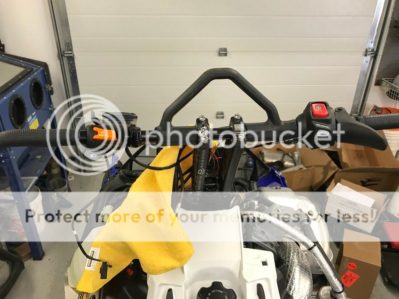

I would be interested in a push button handle bar mounted setup

I have the parts coming will post a build thread soon.

The way I'm setting it up the key will still be in place ....so can start from key or push button. Typically riding in the mountains we do a lot of stop starts. So having the ability to kill power with the kill switch and push button start will be awesome. But the key will still be operational. That my plan.

Wayyyy better...planning on cfr bars so I'm going to try to get it wired in after we are done riding. Then move the handwarmers to the cfr relocation bar with some kind of custom toggles.

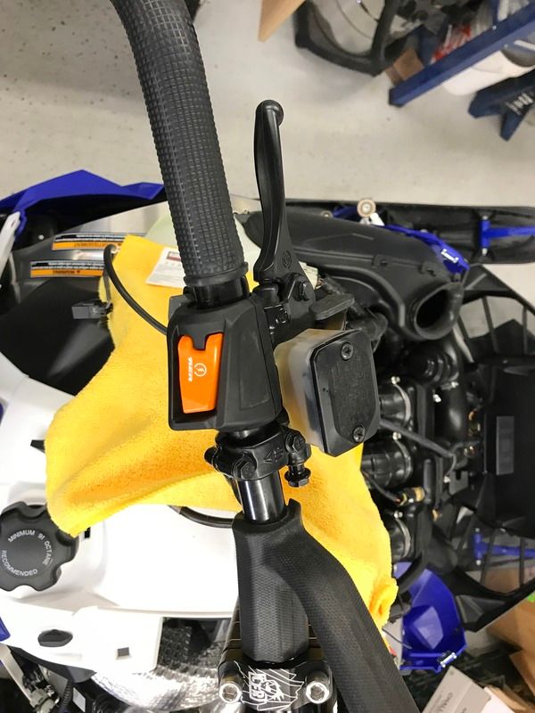

Wow, love the BRP ressie and shorty brake lever, pain to swap that over?

Mounting it's simple...let you know after it's wired. Lol.

You probably have to put a relay in. The RER buttons are just for a digital input to the ECM on the doos. I'm pretty sure on the yamaha the current that pulls the selonoid on the starter goes right through the key. That button might not be able to take it.

Yes for sure ...was planning on using a waterproof pigtail relay.

Really like that break lever, wish I could change mine for one like thatWayyyy better...planning on cfr bars so I'm going to try to get it wired in after we are done riding. Then move the handwarmers to the cfr relocation bar with some kind of custom toggles.

anyone know/see what this new MY18 ''RACE'' brake lever looks like?Really like that break lever, wish I could change mine for one like that
Sent from my SM-T705W using Tapatalk
Im sorta thinking it may be the Tcat one.....Sorta cool, with a small nub to make it feel like a shorty, then beyond the nub it bends down to follow curve of handlebar.

Oh ya, I like it? Where from? I want one!anyone know/see what this new MY18 ''RACE'' brake lever looks like?
