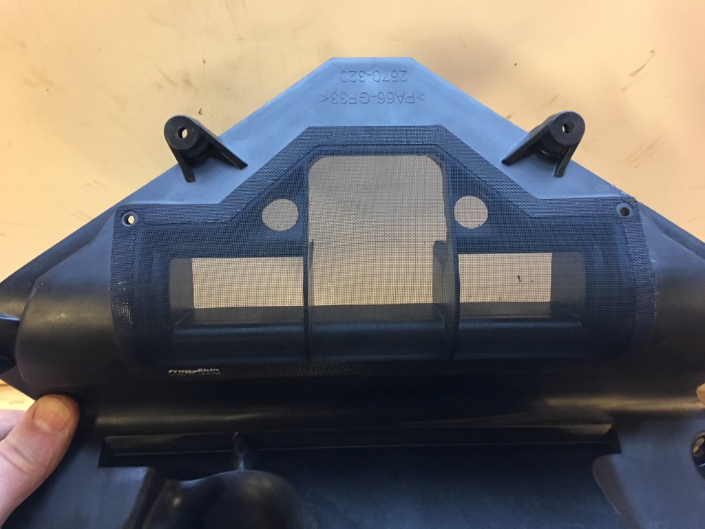

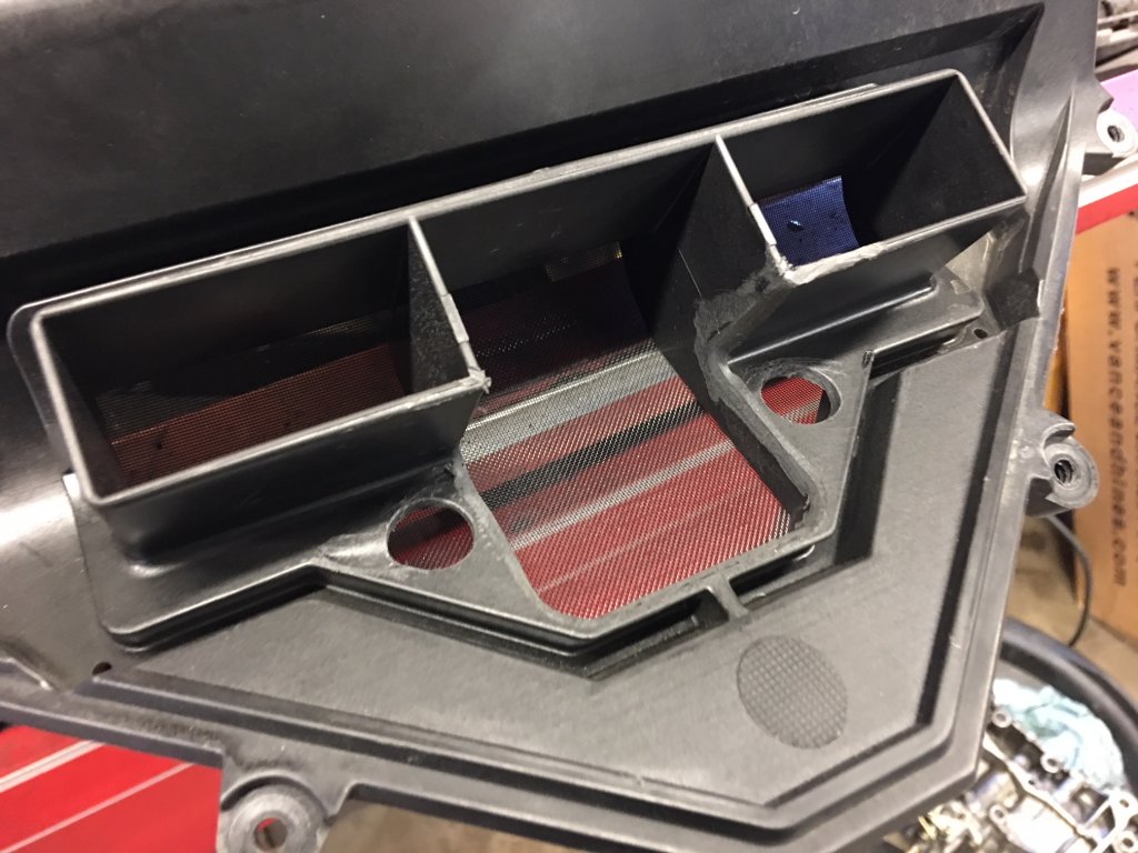

They came through. I would keep cutting. The part triangle part. Then try it. You still have the snorkel? It could be welded back on. Its a big enough piece that if it falls off it wont get sucked in. But honestly I would just try it without.

No It came off in PC's ,I guess it I could retrieve it out of recycle !!!!They came through. I would keep cutting. The part triangle part. Then try it. You still have the snorkel? It could be welded back on. Its a big enough piece that if it falls off it wont get sucked in. But honestly I would just try it without.

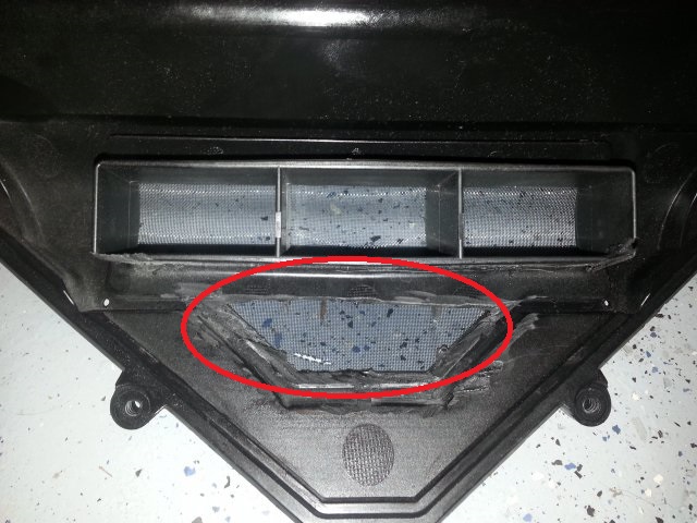

Thanks I'm pretty careful, I probably can knock it out without damaging screen ,I HOPE !Still need to cut out this area. This is where most guys mess up the screen so either get a replacement screen,be careful or just remove and glue it back on. Windshield adhesive or Permatex Ultra black works great for gluing screen back on. The welding can be done with a heated up old screwdriver.

I will check but just got sled only 143 miles, I Doubt it but small amounts of oil in there. What's that about too high of a oil level in engine ?How does your divider look? The flat piece that lays in the upper part of box. Cracked?

So anymore with how me cutting wrong area might / could effect anything in a damaging way ? I seems not to big a deal ! Correct ?

I don’t believe it’s a big deal might even work better since I never tried it. But it’s a pain doing this mod so I would do it like the rest of us have.So anymore with how me cutting wrong area might / could effect anything in a damaging way ? I seems not to big a deal ! Correct ?
