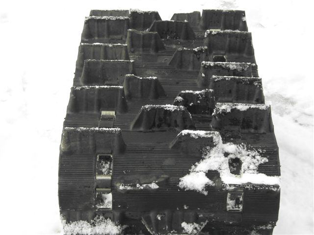

You can not use extroverts with that track unless you open up all of the windows. Some people have used utility knives, some chisles, and others have gotten more creative yet. I have personally never opened up a track myself. There are a number of posts on how to open up the windows on a track and I'm sure lots of people could give suggestions on how they have done it.
tkuss
That was just a track I was looking at buying, luckily I did not. I am just going to wait and look for a good deal on a track with all open windows and one that is fully clipped.
