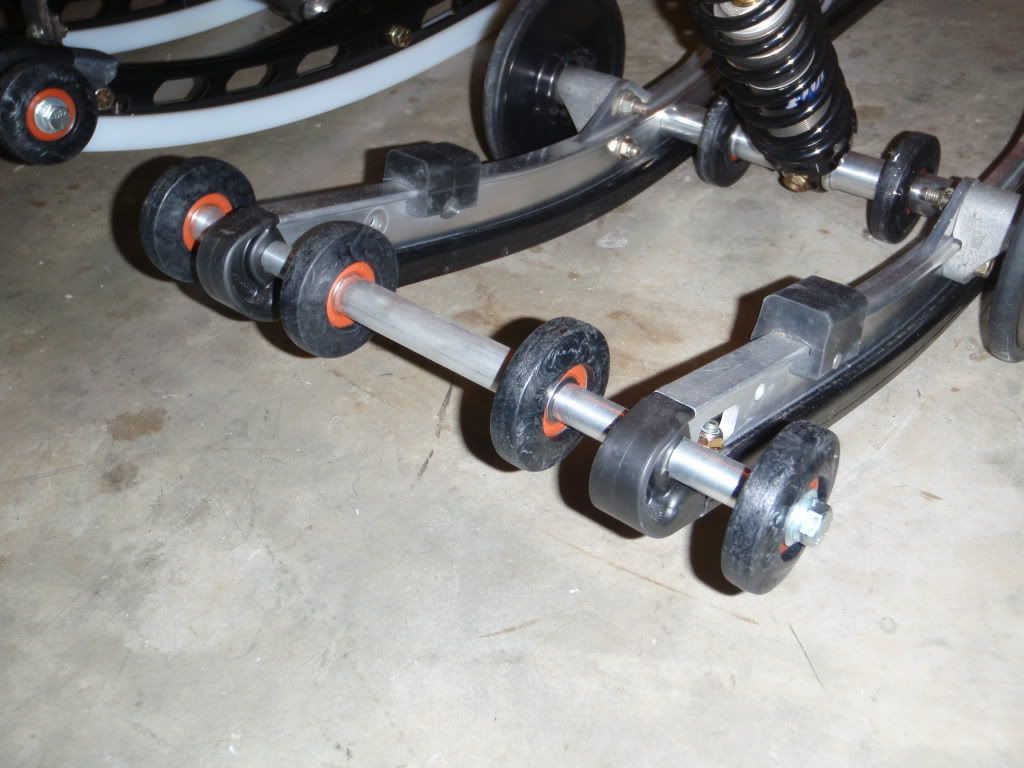

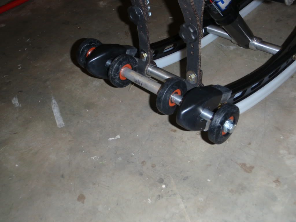

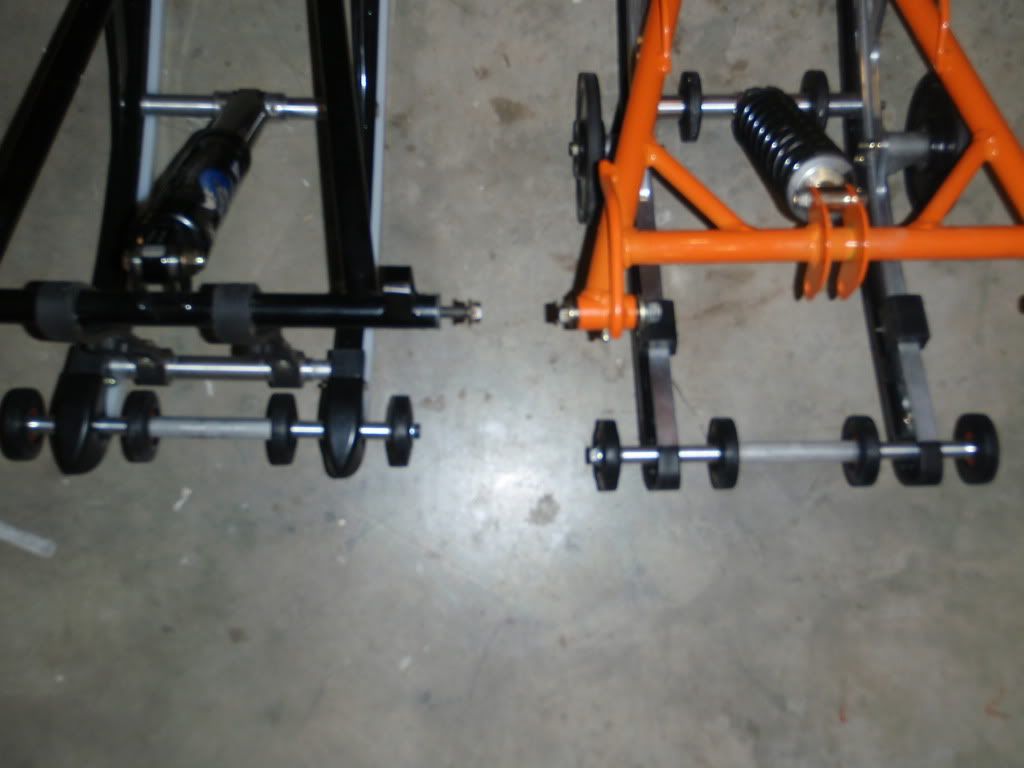

Mateo,
I am using the BDX 4 wheel anti-stab kit on my AC Skid, and adapted the same BDX kit for the Timbersled skid I have, by simply narrowing the antistab shaft 2mm, drilling out a 5/8" hole in the the Timbersled plastic railtips and a 3/8" hole in the rails.
In both the AC and Timber cases, they are 153 skids being fitted to an '11 Nytro.
I agree with MTDream....it probably doesn't matter. The "stab" situation results from an inverted "U" or track wave between your drivers and the front of the rail. IMO, the wheel contact with the track and the fact that the wheels are also on either side of the track windows is what prevents a stab. The plastic tips (depending on rail design) might catch, but not enough for a track wrecking stab. Their advantage, as in the case of the AC skid, is the tips help cut down on track vibration.
Here's my setups:
Here's my setups:
