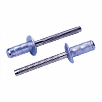

It's a PDF so must be downloaded to see but basically it is just this picture.

i have heard of guys adding a support to help with this issue but you might want to check the pop rivits under the fuel tank as they are known to come loose and cause that issue. had it happen on 2 rx sleds and did my 2011 a few years ago as it is around 37000 km (22000 mi) right now and it had a bunch of loose rivits when i did it.

Thank's for that information. Would you happen to know the part no. for those pop rivets & how many.i have heard of guys adding a support to help with this issue but you might want to check the pop rivits under the fuel tank as they are known to come loose and cause that issue. had it happen on 2 rx sleds and did my 2011 a few years ago as it is around 37000 km (22000 mi) right now and it had a bunch of loose rivits when i did it.
- 7,693
i never kept count to be honest. i buy the large head and small head ones 100 at a time for each type. any time i am doing rivits on a snowmobile, i use them.
the size and type of rivit
i get mine at my local fastenall as they keep them in stock.

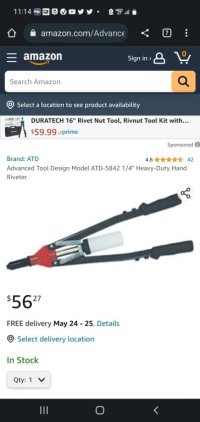

i reccomend using a harbour freight version of this tool, https://www.blindrivetsupply.com/FA...-Nut-Tool-Spin-Pull-Spin-M3--M8-_p_40912.html, as those rivets are a bear to do by hand.

Ok, cool! I just saw the $1500 price on the link, wasn't aware HF had a $60 model. Yeah, go for it.True, but as main pointed out, Harbor Freight air riveter is priced about the same but less the effort:
- 7,693
i started with the harbour freight version after doing 1 sled by hand and wore it out as i liked it so much. up graded to a mac tools one and love it.Ok, cool! I just saw the $1500 price on the link, wasn't aware HF had a $60 model. Yeah, go for it.
