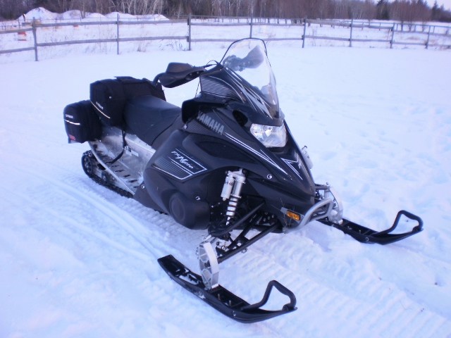

Finished doing some upgrades to my machine and got a few miles on it this week with good results. Just wanna say thanks to everyone that contributes to the forum as most mods were made from suggestions from this site.
- pet screen on vents
- relocate feul vent hose to handle bar clamp
- nylon washers on clutch roller bolts
- remove tunnel stud guards
- shorten limiter strap one hole
- Excell X wheel kit
- 1900Nm torsion springs
- Schmidt Bros. cold air intake kit
- Schmidt Bros. comfort clutch kit
- Schmidt Bros. tunnel closer plate
- white sliders
- Yamaha fuel caddy
I coated my selenoids in Flex Seal to try to remedy the problem of not starting after putting some miles on and than shutting the machine of for awhile. I also installed a custom skid plate I made from some aluminum I had around. So far I love the clutch kit and haven't noticed any wear or smell of plastic burning coming from the sliders. I still need to do something about the heavy steering and darting but that will have to wait as the well has run dry for now. I will probably go with the OFT relocator bracket and some sort of riser, just not sure what height to go with. As far as skis it is a toss up between the Split Rail or Curve XS with the leading edge accessory.
Thanks again. :rocks:
Here are some pics

How does the comfort clutch kit perform , I was thinking of getting one for my wifes 09 nytro 121 .
We have twins...Not many black ones like that around. I like mine a lot. Mine has the comfort clutch kit as well. It made a huge difference. No more whip lash, especially when trying to back up.
X2 on the comfort kit. I love it, much more control at low speeds and still lots of torque. Also super simple to install, just a spring and new rollers for your primary. Been riding to work and back for two weeks with it now and I still haven't noticed any slider wear with the excell kit and white sliders with minimal snow. Coming down now but not much in forcast.
