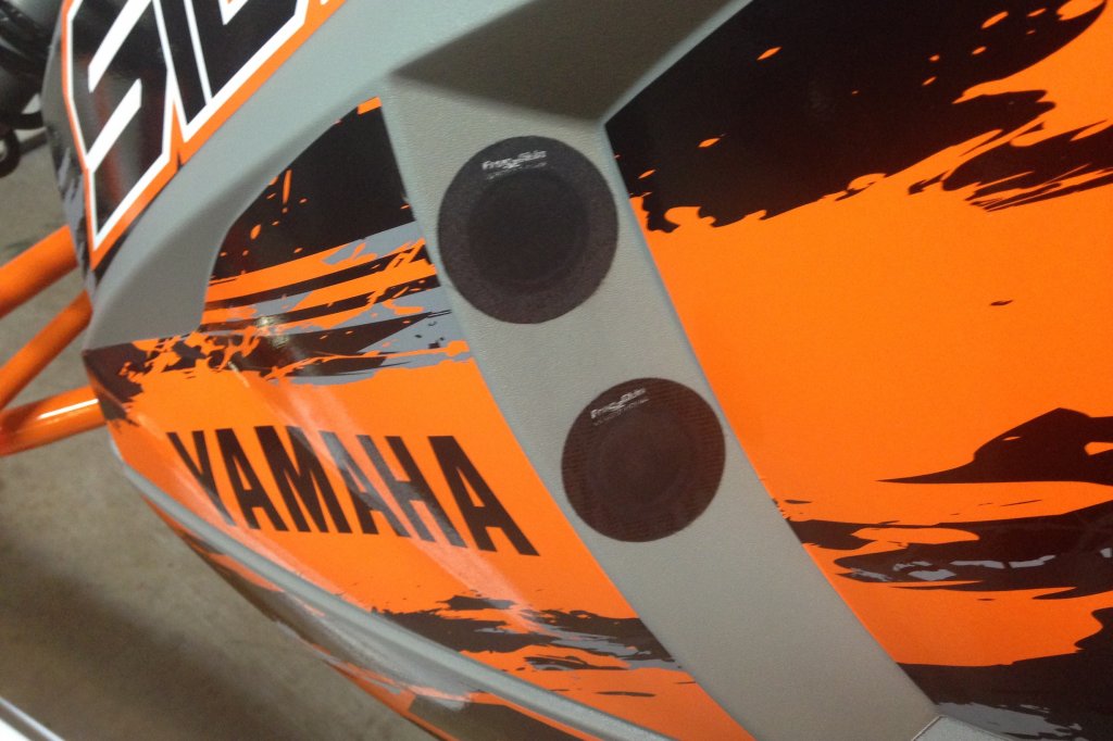

One other thing that might be influencing cool clutches. Frog skin vents. Only minor issue is you will get belt dust on your left ankle. Not seeing a lot of belt dust but some. I feel with the vent up front it pushes Some dust onto your left ankle area.

I will be looking into some venting this summer.
Those are Frogskins?

Yes. Pretty easy install. Drill the right size and stick. I bought a few extra just in case you get a WTF moment and punch a hole in them. They give dimensions of OD and such on the website. Only draw back and not a big issue IMO is blow through dust. But at 250 ish hp I really don't see any clutch set up not having any belt dust. Been drilling that front hole on the procross chassis since 2012. The location is tucked enough behind shock and blows right on belt. Never had any issue with anything but air going through. Good product and very good stick.
