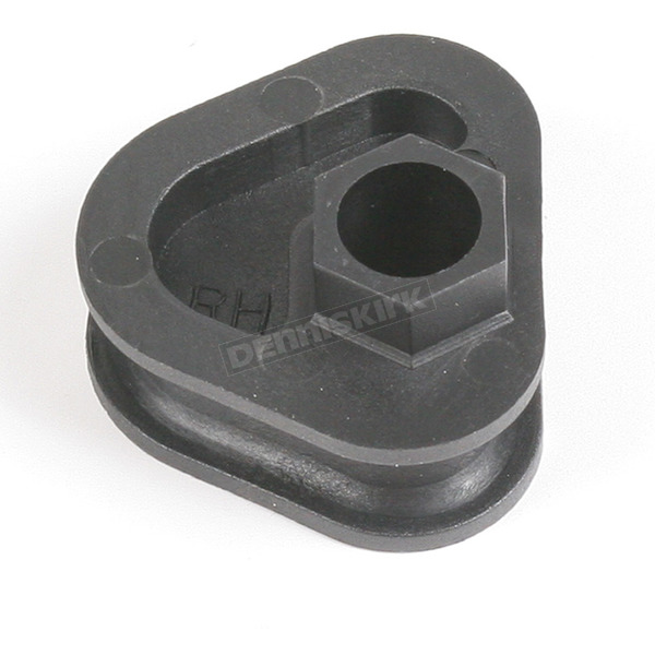

It does not have float style air shocks. There is nitrogen in the shock but that's different.
You should have a part in the suspension that looks like this:
Make sure that it is set on the thinnest side. That is soft.
If that's not enough Barn of Parts has some remedy's

There SRX has torsion springs and blocks on it that can be adjusted for weight. You stated they were set on #1. Can't go any lower than that. Make sure all the dampening setting are set on low or #1. Beyond that you'll need lighter torsion springs.

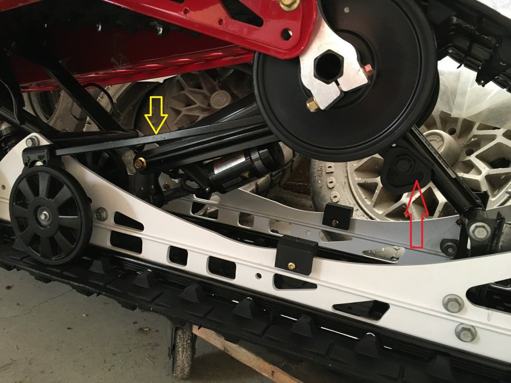

Red arrow is the adjuster......yellow arrow is the other end of the spring, which is coiled up behind that big idler wheel
