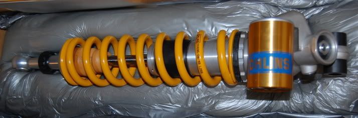

can somebody put me in the right driction so i can send my shock , and have the ec removed from my rear ohlin shock, and make it a manuial adjustment, this is the second time i broke the wire, and since i dont adjust it much , i was looking to remove the unit, any iinfo would help thanks
Bruce at Pioneer Performance 716-496-8800 should be able to convert your EC mono shock to manual adjustment. However the question that you should be asking is why the wire keeps breaking.
If the wire is routed properly it should not be breaking. There was a technical bulletin to correct the wire routing in 2007. Here is a link to the bulletin. http://www.ty4stroke.com/download.php?id=29280

Bjowett from this site just did this to mine. No more damn broken wires, lol!!!
Please note the top compression clicker now and no EC wire on the top of the shock. Mine ohlins also has Ohlins PDS system and a progressive racing European valve stack. She should really rail this winter.

can you adjust the comp on the shock or is it a lock postion and valve diffrent for the ec missing
That bolt thing on the top is a 14mm that adjusts the compression. Turning the nut left adjusts compression down. Turning right elevates the compression adjustment.
The rebound adjustment is still the knob on the bottom.
