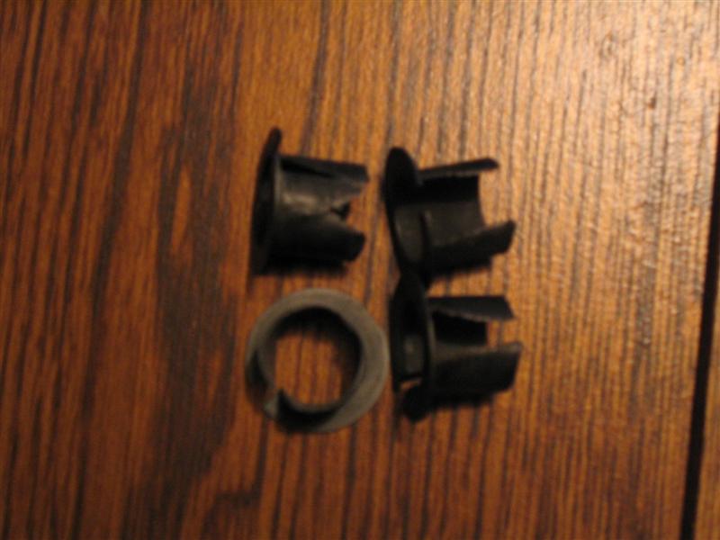

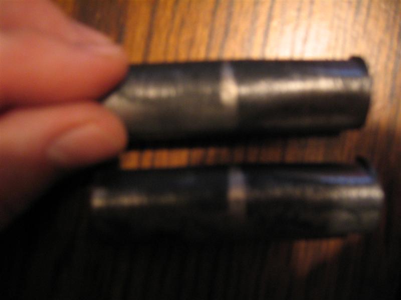

Sierraspirit
Extremely Worn Bushings
Here are couple pics of my bushings from a 2005 skid. I removed the skid for inspection because of all the complaints on this site. I found the bushings destroyed, take a look. This sled has around 2000 miles and riden easy. My A-Arm needs couple welds too, pics if you want. I am talking with the local dealer, of course they will not cover anything. I am disappointed, my 03 RX1 ER had 5200 miles, not a mark on the skid and bushings fine when I traded it for the 05. This 05 skid has paint coming off of all the welds, not a good sign, which is why I need to have someone weld couple areas on the A-Arm. I am going to get someone to weld on 5/16 grease nipples too. This should help, (approx. 8) at various points. Good luck to others who haven't inspected their skids yet.

where are these all loacated....i only know of 4,,,,2 on front arms and 2 omn rear armsExtremely Worn Bushings
