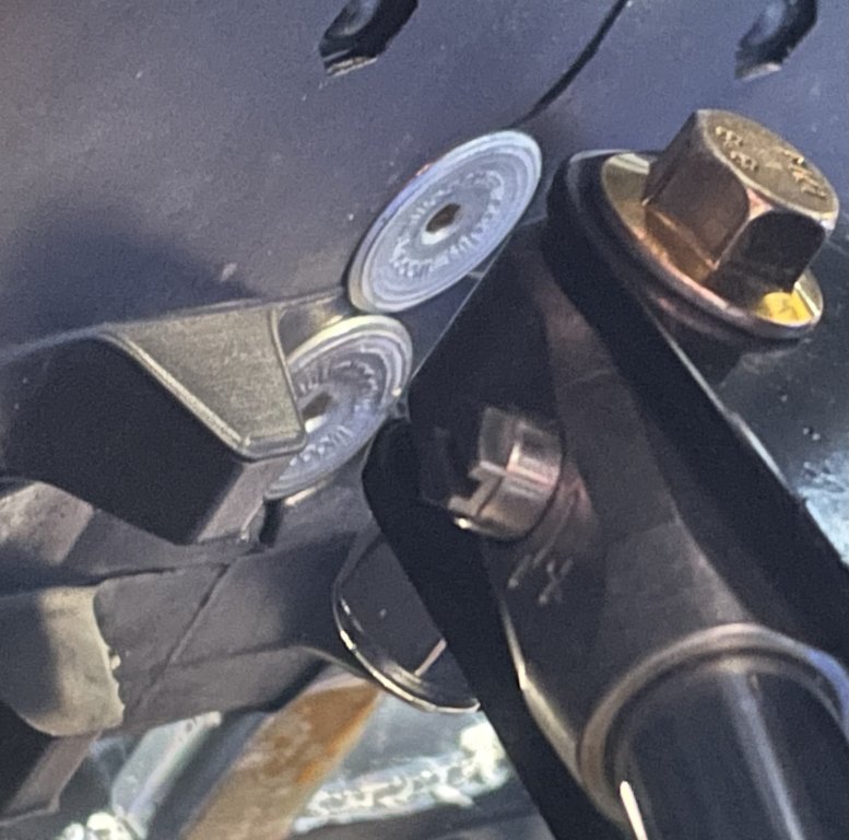

This the rebound for rear shock then?
shawnj

Yes, thats the rebound adjuster. Using a coin to turn it makes things easy.
shawnj
Thank you. So turn toward the plus sign to slow it down I take it.Yes, thats the rebound adjuster. Using a coin to turn it makes things easy.
