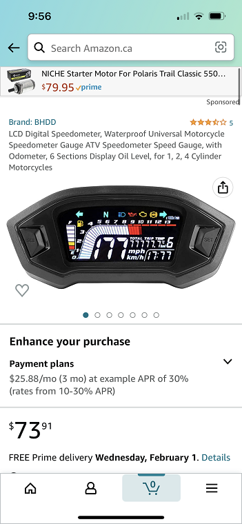

Anyone have any experience with these amazon cheapo gauges? would like to try to get one of them to work, however all i see is for 1, 2 or 4 cyl engines.

I am guessing those cheapy gauges will be junk and frustrating. I would look at a koso at the min like this for $280:

That koso looks good but has led me to other questions, it appears the spark pickup is made by wrapping a wire around the spark plug wire. However i have been told that the 700 is a wasted spark engine. Meaning every coil fires all the time on all cylinders. So in one revolution the gauge would see three spark events. The tach would read 3x as high. Whats the answer to this?
option two is it can connect to the crank trigger on the flywheel. I assume the flywheel would also have three triggers (one per cyl) so even if it was connected here we still have the issue of three spark events per rotation.

What does the stock Tach use for a signal? On wasted spark coils there is usually a output for a tach, not sure on the red head wiring though.
