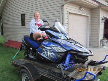

When mine peeled off on one side . I went with a full graphics kit instead of buying the 2 decals I needed . It was more money but made the sled look better !

Most kits are OEM quality and go on fairly easy. You basically need a good hairdryer to heat the old stickers up then start peeling them off as you warm them. A heat gun would be to much! Then some Goo Gone solution, which can be found at most dollar stores. Use a nice soft cloth full of Goo gone and get all the sticky residue off. then finish with some good 91 % isopropyl alcohol to make sure its clean. Cut out parts to match up to panels on sled. you can peel and stick dry or with a soap solution. Lots of videos on You Tube to watch. With my Daughter helping me it took us 4 hours from removing the panels on the sled until reinstalling them back on.
It turned out to be a good bonding moment and she takes more pride in her sled.
