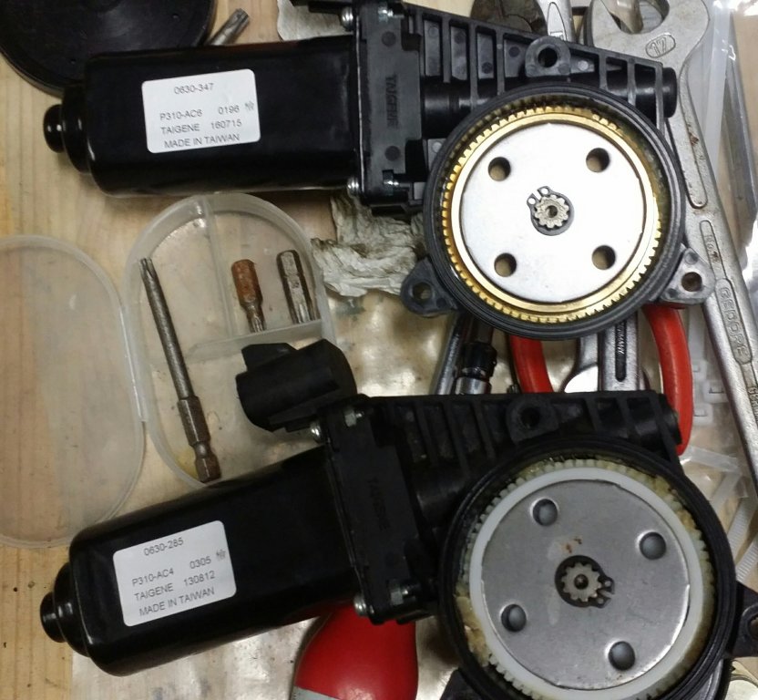

Janne339
- Oct 31, 2015
- 559
- 395
- 738
- Sweden
- Sweden
- 2021 Sidewinder LTX GT
My reverse actuator fail
New update actuator and the old white plastic one.

My actuator failed this past week also. I removed the plastic gear and rotated it aprox 120 degrees it in the counter clockwise direction and reinstalled and it's back working like new. The new updated brass gear should eliminate most all the actuator gear failures.
Mine failed in second season I believe. New one has been flawless for well over 5-6000 mi. I wonder if its brass gear?Is the 347 part# Janne has on his brass one a reliable indicator?
I think the brass gear is a fairly new update, my actuator was replaced just last season under warranty and it has the plastic gear.
Yea it looks that way.I think the brass gear is a fairly new update, my actuator was replaced just last season under warranty and it has the plastic gear.
