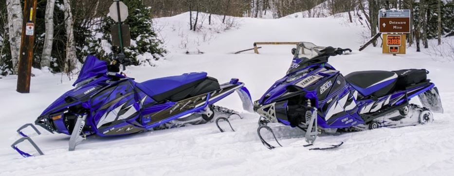

The 1.5" lug Rip II track is not available with the quiet bumps. For what it's worth I installed the 1.5" Rip II track on my '21 SRX this year. I do most all of my riding in the UP of MI in great snow conditions and occasionally like to venture off trail so I need something with a deeper lug. Don't run studs. My wife has the Storm 150 track on her 'Winder. Both tracks will do a decent job off trail as the picture shows.
IMHO I would say a studded 1.5" Rip II track would be ideal for any 'Winder if you want/need studs. I've found it to actually be quieter than the Storm 150 track. In the same conditions I've found that the 1.5" Rip II track will have more forward bite than the Storm 150 (both unstudded). I believe this is because the Storm 150 has 1.5" lugs on the center band only and the outer bands are 1.25" where the 1.5" lug Rip II track has the same height lugs straight across the whole width of the track.
Both tracks do pretty well off trail. I believe that the Rip II has a harder durometer than the Storm 150 track so it won't fold over the lugs under hard acceleration like the Storm 150 does.

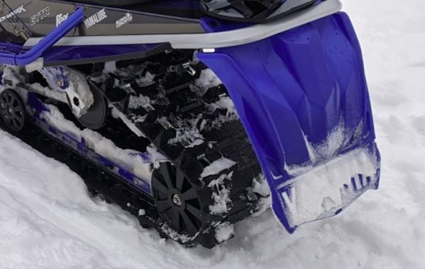

Close up of the 1.5" Rip II track on my SRX. You can see how well the track lugs will bite into the snow:

The outside lugs on the Rip II are angled to allow the track/sled to slide a bit in the corners instead of pushing the sled. I have fun sliding through the corners under control using the throttle to help point the sled.
My track is not studded. Definitely not a point and shoot type handling track unstudded. If studded that might change the handling characteristics.
