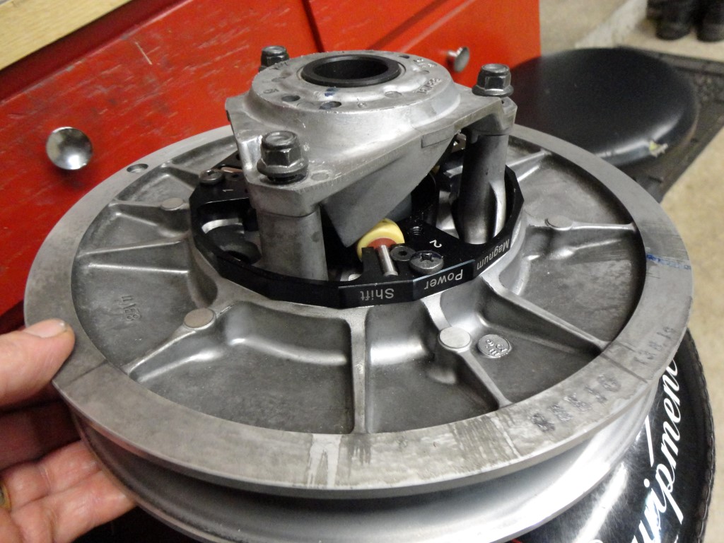

As you all know I am a bit jealous of the Sidewinder guys so trying this to be like them! I cant say enough good about the service Hauck gave me. They were fast,Reasonably priced and very easy to get ahold of and talk too. As well as doing a excellent job machining after I made a BooBoo myself.
(Thanks Barn Of Parts for Nice Secondary!)Reasoning for me buying. Had a Aaen roller on my SRX and loved it. I have gone through buttons almost every year and the Yamaha ones are expensive. This wont give me Top End but it should give me faster backshift and therefore faster acceleration when getting back on gas. My high gearing demands some mods to get the lowend snap back. Pretty happy with it after the primary roller change but this should help even more.

had their roller on my 600 sxr worked fantastic

I've had 3 of them. Friend of mine used to make them for Hauck. Stock up on rollers and pins.
Really? Hope not.I've had 3 of them. Friend of mine used to make them for Hauck. Stock up on rollers and pins.

let us know how you like it. i have one ready for a spare that i might try with the orange secondary spring redbeard gave me.

I don't hear of too many running them but I bought my 15 LTX SE with an STM roller secondary. Hopefully it works well.

You can buy the fixed secondary sheave from a sidewinder and pair it with viper movable sheave. And then you have a sidewinder secondary.
Have you done that?You can buy the fixed secondary sheave from a sidewinder and pair it with viper movable sheave. And then you have a sidewinder secondary.

Have one here and ya, it Will work, its the same sheave but the 3 bolts is not threaded
How’s does it work? Is it worth doing?
Boy those parts are really cheap too! Dang it!
Angles are same?
