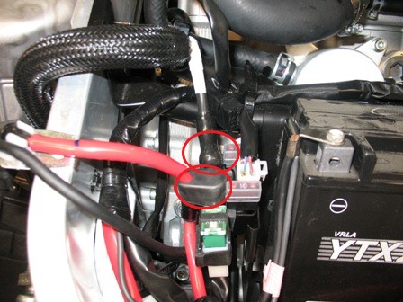

On the starter relay, there are two posts with nuts on them. One wire from the battery and the other that goes to the starter. Use a tool like a pair of pliers or a screwdriver to jump battery power directly to the starter. There should be a fairly big spark. Pull the two rubber boots and jump the two terminals (circled)

Thank-you sir.On the starter relay, there are two posts with nuts on them. One wire from the battery and the other that goes to the starter. Use a tool like a pair of pliers or a screwdriver to jump battery power directly to the starter. There should be a fairly big spark. Pull the two rubber boots and jump the two terminals (circled)
