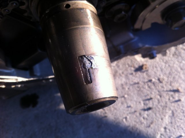

I had problems to get the alignment marks on the magneto rotor with the TDC of the #3 piston, so I took of the casing and the rotor. There I saw that the woodruff key was broken. The cams and pistons have probably been ok the hole time, but the timing of the ignition have been 90 deg off.

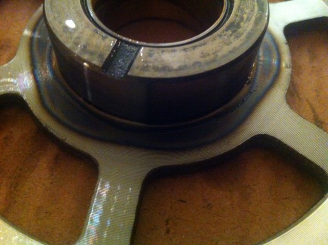

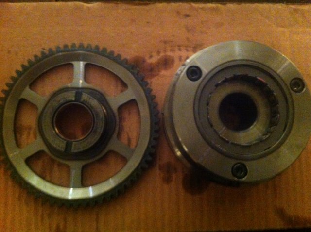

The one way bearing in the start clutch seems ok, but there is some heat marks on the starter clutch gear. See pictures. Do anyone know if this is normal? How easy should this one way bearing run? There is some resistance but not much. Should I change the one way roller bearing ?
