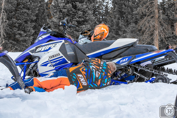

Ya but what you don't tell is I was on the other side in the same position as youcannondale, thanks for you research. I must add a few things here. First of all, I had removed my two idler wheels prior to even riding it so its not them. I have anti stab wheels and they don't seem to be the issue. My drivers are hitting almost the center of the windows. Second when the sled was sitting on the ground with the shocks at riding pressures you could take your hand and take the top part of the track and push it up against the tunnel with very, and I mean very little pressure. I tried it, Yamarob and Stingray and Justin witnessed it. These are three Viper owners although different flavors. You could not do this with any of theirs. One 137 and two 141's turned to 153's with extensions.
We tightened the track until there was next to no slack as well as putting 160 lbs in the front shock. All that happened was the sled rode like a rock and it made lots of noise although a bit less. We spent a whole day at Mesa playing with this. The only positive thing is that while Jacob and Norm were folding up their front ends on huge rocks boondocking, I was lying on my side working on this.
Nothing worked until I lowered the skid. Then it went away and I actually have some sag in the bottom of the track.
I think that if you have a 2016 XTX-LE then drop the skid down. It wont affect the ride but will stop the noise which sounded like a truck going down hill and using engine brakes and missing the odd gear.

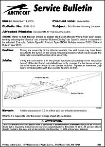

Any way you can post a link to service bulletin or larger . canT read it . TKSView attachment 113698 You do not have to relocate the shock at all. I just purchased the HiGear 45 degree offset top cap and it will allow the Evol canister as well as having the idler wheels. Arctic cat actually has a bulletin on the rubbing noise. They say the skid should be in the lower holes.

Not sure why the forum does that. It was a jpg on my computer. It is from HCS. http://www.hardcoresledder.com/foru...502050-2016-xf-8000-limited-high-country.html.
It basically says to lower the front down and go to the middle hole in the back.

Right. But when the Hygear links are added there is more involved than previous years. That must mean a geometry change at least in the 141 Le.View attachment 113698 You do not have to relocate the shock at all. I just purchased the HiGear 45 degree offset top cap and it will allow the Evol canister as well as having the idler wheels. Arctic cat actually has a bulletin on the rubbing noise. They say the skid should be in the lower holes.
