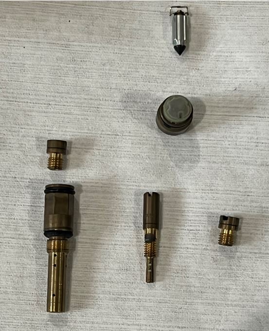

It's possible you need to re-sync your carbs due to replacing the exhaust donuts as there are adjustment screws between the carbs but it does require a synchronization tool. When you mention you checked the carbs and they were cleaned, did you do just remove the float bowls and clean the carb like this:
Or did you actually disassemble the carb and remove the jets and needle valves like this:
The reason being is that there are tiny holes in the jets that easily get plugged and sometimes just spraying carb cleaner in the carbs isn't sufficient to actually clean the small orifices:

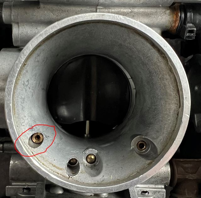

Along with the jets under the float bowl, there is also a small jet in the mouth of the carb that I also remove and clean:
