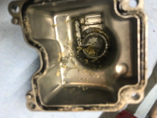

THIS is what our Rx1 carbs looked like full of the Ethonal crystals ,after sitting for the off season , with Starcon in the fuel, gas was flowing into the air box , and flooding the engine out ,So far that's a yam only part , its time to replace em all
had 3 carbs doing it , haven't had a sled do this to me in years , I am going back to using the Lucas Brand Ethonal additive , ran that a couple years never an issue .

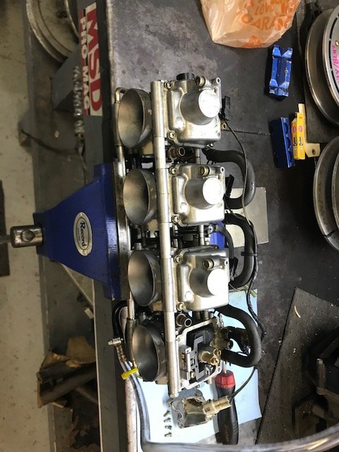

Thanks Guys I replaced all the O rings and needle and seats. Set the idle air screws two turns out. That fixed the overflow problem. I sync the carbs set the idle at 1500 rpm. I now have a bad off idle hesitation Never had this much problems with a rx 1 Any Ideas ThanksTHIS is what our Rx1 carbs looked like full of the Ethonal crystals ,after sitting for the off season , with Starcon in the fuel, gas was flowing into the air box , and flooding the engine out ,
