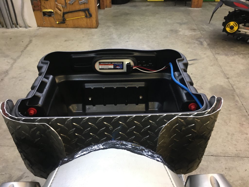

Parts:
Action packer tote.
Led sealed tractor trailer type taillight.
Solder And heat shrink.
Thin sheet of 24x24 checkerplate aluminum.

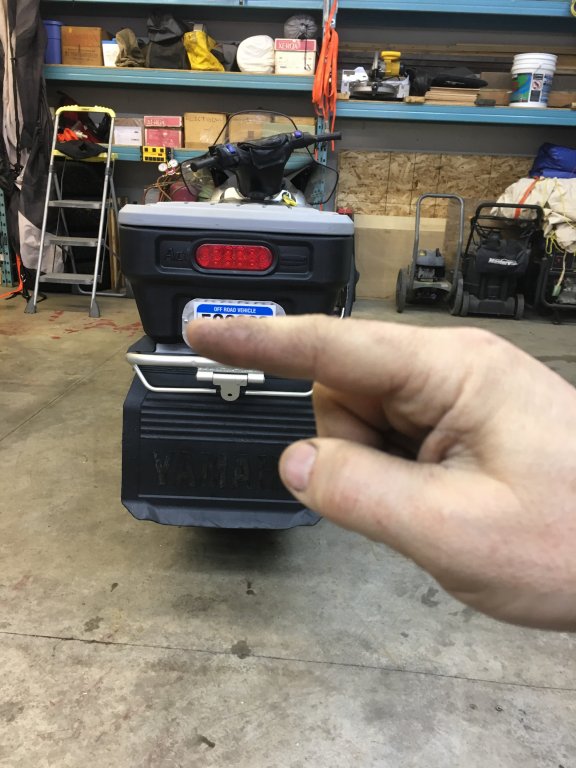

1 test ride in. About 75 km covered. Gear stayed dry and surprisingly had no exhaust odour despite obviously rich exhaust.

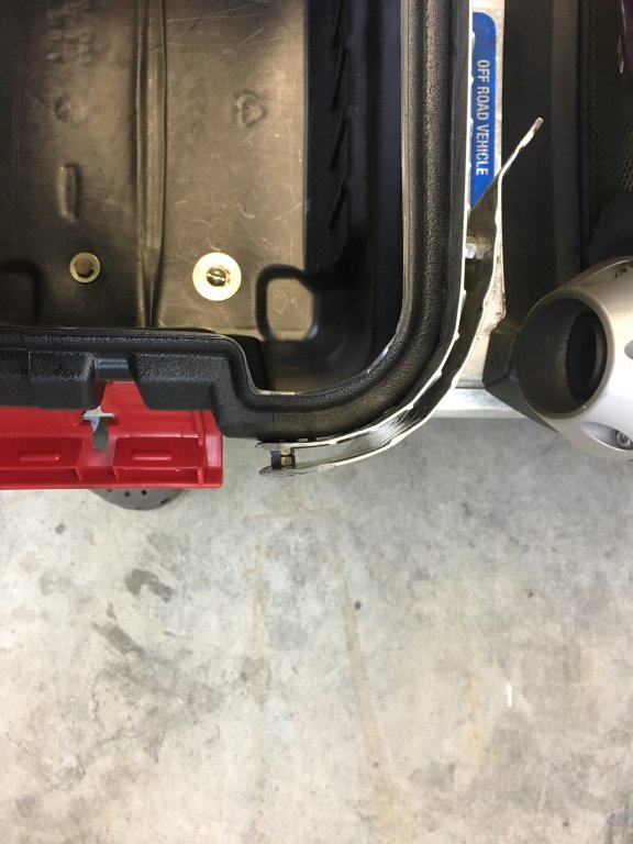

I mounted my aluminum heat shields even with the top of the lid to protect the gap.

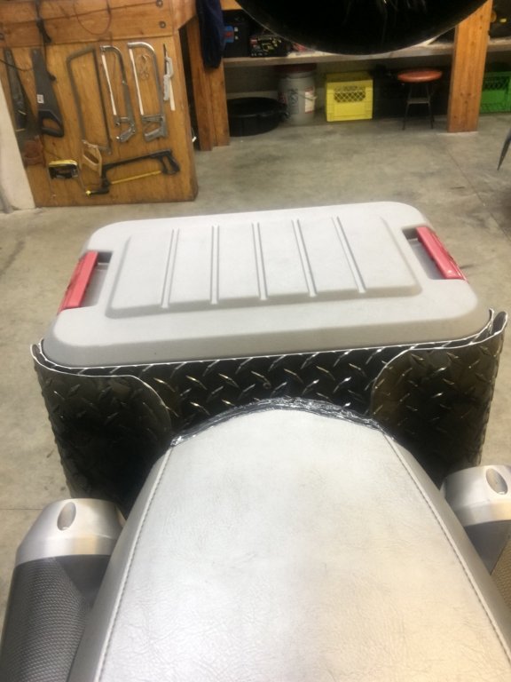

Lots of storage for a gear and I don’t even notice it’s there even when riding one knee up on the seat.
