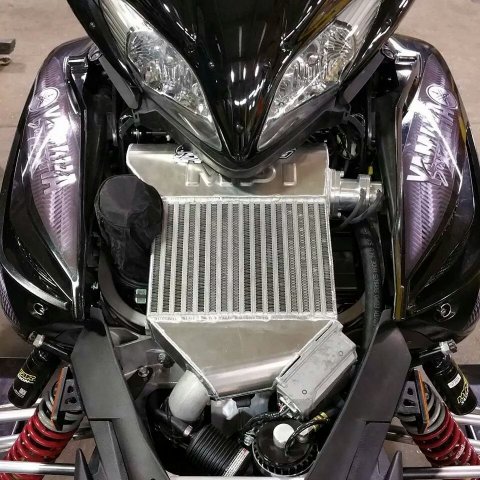

Well she is back from Ulmer, Went 7.5lbs of boost with a 136" track for this year. Added the Hygear front, and rear dual rate springs, and rebuilds to the sled also. Now all I need is snow to try her out. Really interested to see ho it performs compared to my past Nytro... I know the Apex squats better at take off, so should be interesting. Found a way to carry some extra fuel. So will be working on that next... Thanks for the help, and input to Kinger, and Ricebrunner

Well she is back from Ulmer, Went 7.5lbs of boost with a 136" track for this year. Added the Hygear front, and rear dual rate springs, and rebuilds to the sled also. Now all I need is snow to try her out. Really interested to see ho it performs compared to my past Nytro... I know the Apex squats better at take off, so should be interesting. Found a way to carry some extra fuel. So will be working on that next... Thanks for the help, and input to Kinger, and RicebrunnerView attachment 102712 View attachment 102713 View attachment 102714
Awesome.
Let us know how you like it.
I'm thinking that is the ticket for trail riding.
