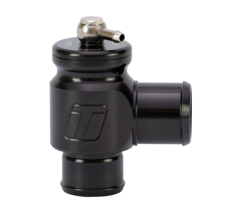

What BOV was ran together with the 3» heartbreaker and 240/270 race tunes - Stock, reversed stock or aftermarket BOV?We have received some calls recently asking about our 3inch exhaust systems with Hurricane tunes for the 998's.

Turbosmart:What BOV was ran together with the 3» heartbreaker and 240/270 race tunes - Stock, reversed stock or aftermarket BOV?
TT
Turbosmart:
Did not Ben at Turbo Dynamics have a thread about aftermarket BOVs causing a lean condition beacuse it was overboosting vs. the stock BOV on their TD MAX 17 tune?
Would the super efficient 3» heartbreaker exhaust from Sandale and this BOV lean out the tune even more?

Depends how you look at it with the BOV... if the stock one can't hold the boost and bleeds off then the tune will go rich as it is not seeing the boost it is tuned for. We saw a huge upgrade going to the Turbosmart BOV, it just allowed us to see the boost we needed to see. Hope this makes sence.Did not Ben at Turbo Dynamics have a thread about aftermarket BOVs causing a lean condition beacuse it was overboosting vs. the stock BOV on their TD MAX 17 tune?
Good Hurricane and Sandale are supplying a fix with updated tunes!
Like I mentioned above, we have no experience with the TD tunes so I will not comment on them but in fairness to Ben and TD there's no doubt his tunes are great.

So just to clarify, by adding the Turbosmart BOV, this will NOT cause overboost more than the intended PSI for the respective tune. Is that correct?
