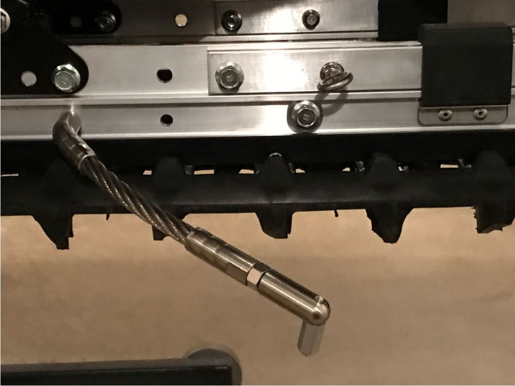

Do you happen to have any pics of the one's on the rail? Thanks-i have the cable scratchers mounted on the 2012 apex xtx skid i have in my 11 apex xtx. as gf rides it more than i do, they are always deployed unless she hits a funny dip and one bounces back on the rail. she does not know to pick them up to reverse witch is why i went with the cable ones on that sled. still on the stock tips.

Here's how I did mine. Used an existing hole but had to slightly enlarge it to fit the thread size of the cable scratcher and then used a stainless steel eyelet as my retainer when not using them:

i did the same thing as RobX-1. used an existing hole behind the forward most out side idlers and my set have an anti rotation hole that i had to drill. i did buy the storage eyes but never used them as i only put them up when loading to go to a ty ride.

I added the eyelets last year, as mine kept falling off the rail, and were actually wearing a gouge in the rail. The eyelets worked great.
I don't have mine deployed all the time, as they work, and fill the skid with snow which turns to ice, and soon I have 75lbs of extra weight on cooler days.

I two mounted the Duraflex brand which I like more. On the side rails in an existing hole. And added SS closed eye bolts to hold them. They are amazing scatchers. Never break or bend. In and out of the trailer or what ever. Many years and miles on them. Same for the wifes sled.

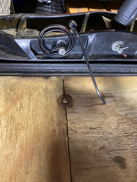

I use the ones from Yamaha (I think they call them TRIC) and attached them to the sway bar arm holes using a bolt and nut with a hole drilled in the bolt right behind the nut and have a spring clip in that hole. This setup allows me to remove or attach the scratchers in just about two minutes with no tools.

I’m pretty happy with these reversible snowthrowers

I really like the look of those. Now I just need to source the materials to make a set. What is the coil from or did you buy these?I’m pretty happy with these reversible snowthrowersView attachment 169419

I have a set of SnowThrowers available if you’re interested. I make them, along with some other products. PM me so we don’t bog down this discussion.I really like the look of those. Now I just need to source the materials to make a set. What is the coil from or did you buy these?
