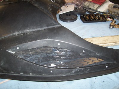

Finally had to do something about the side panel vents. Every time I'd roll the sled the vents would loose a clip and partially fall out resulting in 10 minutes of hassle in putting one back on or having snow in the clutches. I cut and bent 3 small tabs out of sheetmetal and riveted one side to the plastic and the other side just backs the vent. I also put 2 rivets through the vents themselves. Now I can roll it over and over and not have to deal with the vents popping out.
