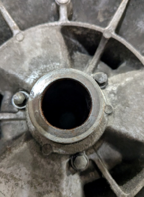

Is this the correct clutch that doesnt require the modifications?
- 8,048
- 2,137
looks correct but you need to measure the spline depth as that is the main difference. yamahas did the mod for his phaser if i remember correctly.

Do you know what it came off of.Is this the correct clutch that doesnt require the modifications?View attachment 177534View attachment 177535
The 95-96 fit.

I purchased it from Ebay, it said 1996Do you know what it came off of.
The 95-96 fit.

Details on measuring the spline depth?looks correct but you need to measure the spline depth as that is the main difference. yamahas did the mod for his phaser if i remember correctly.
- 8,048
- 2,137
this thread has the info needed to make sure the spline is the right legnth.

Thanks, I am hoping I can see the later model and the older model side by side inside the splines. Not visualizing it very well.this thread has the info needed to make sure the spline is the right legnth.
