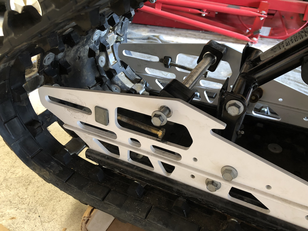

Yeah be sure its same as it was originally....I think some guys use a ratchet strap to install easier too....I found that removing rear wheels makes skid easy to get in/out of track....using a lift/hoist on rear bumper allows you to lift/lower rear incrimentally and aids in lining up.
I have a RTX too(129'') so your skid should use same holes as mine...
Pics below,
Dan
Rear skid uses upper holes
Front Cross shaft bolt location(RTX)
Wheels/Axle out easy removal of skid
Pics below,
Dan
Pics below,
Dan
