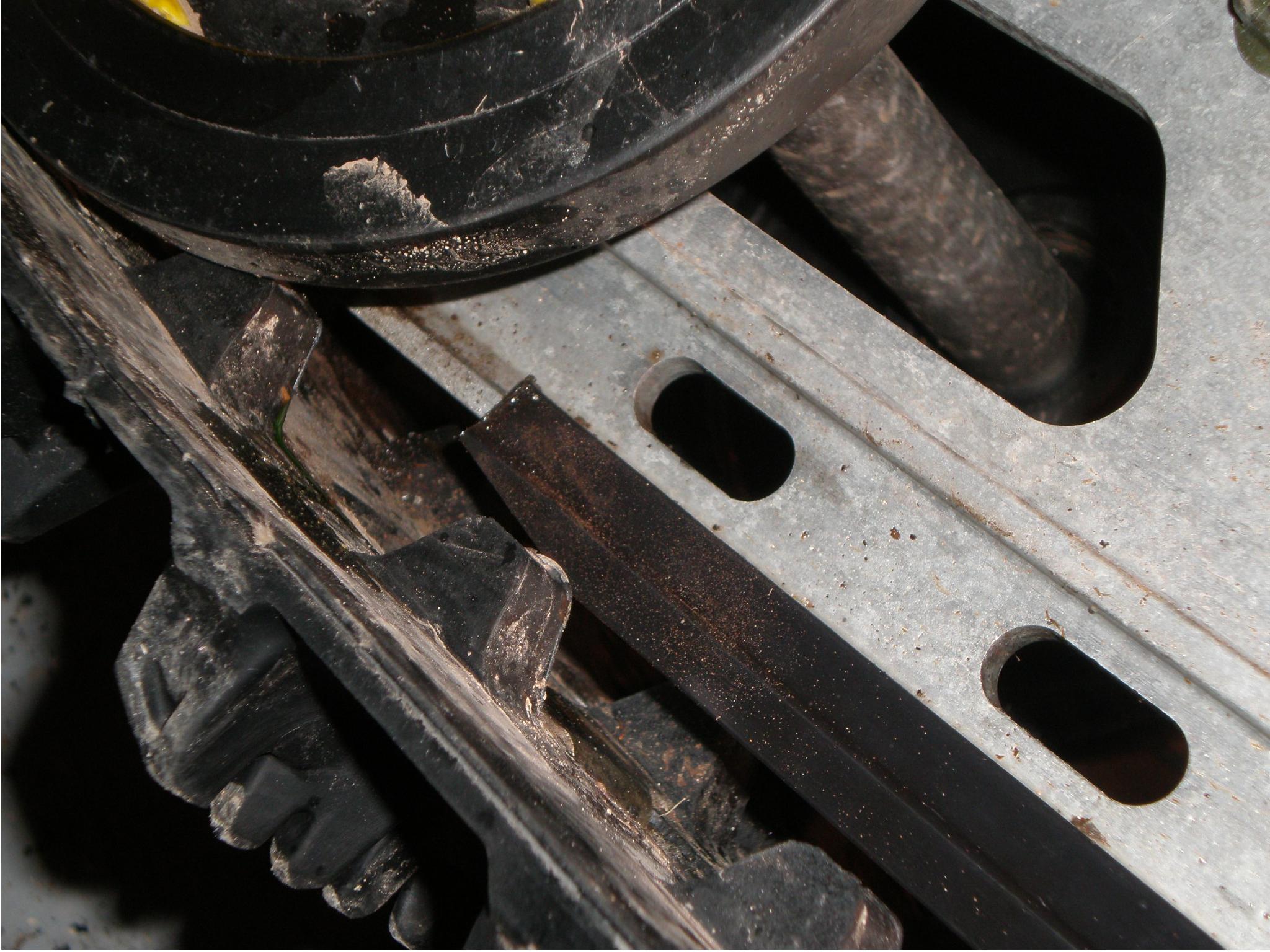

Anybody buy some yamaha hyfax and find they are almost two inches shorter than the one they took off ? I just threw one on an about 3" of rail was exposed . Im taking them back and I will see what they say.

They gave you ones from a different model, should be a simple exhange but I would recommend double checking the part numbers.

doesn't hurt a thing, if ya got it all back together don't worry about it.

these are the ones you want,...they are yamaha sliders and skinnier,they last longest IMO and fastest top speed.
Graphite 121"
part # SMA-8CM92-70-HP

like Rockerdan said, go with the graphite ones that are alittle narrower, less drag more speed
