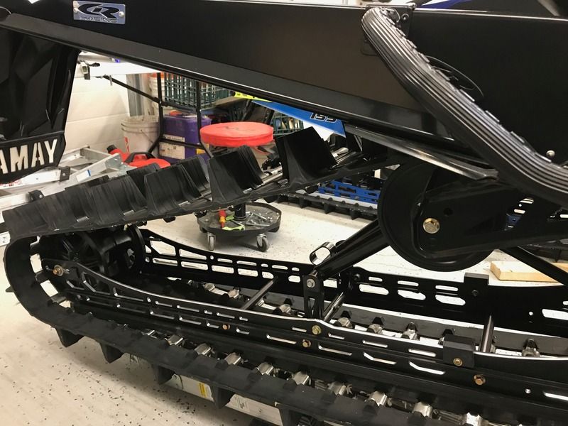

Just thought I’d start a post on my current Yamaha Sidewinder 174 build. Also probably keep the thread going through the winter on how the sled is working. Here’s a brief overview of what I’ve done this summer . Installed CR racing 174 tunnel extension, boards, and exhaust. I went with camoplast 174 9271m mostly because the deal was worth it...i figured worth a try......installed avid drivers. I kept the suspension in stock configuration for now. Iceage cut me a set of 174 rails...i am planning on going with different ski and rear skid shocks...currently working with a company in canada to get that figured. Also have wired in push button start and reconfigured the handlebar controls. More to follow....will post some details over the next few days.

Last year I only rode the sled a handful of times, including the demo ride .... which sucked me right back to Yamaha. The sled worked so unbelievably well out of the box I was impressed. There were a few things, like always, I need to change to make it better for me riding style.
First off, I’ve always liked the feel of a 174” track, floatation, and traction. Chad at CR does an amazing job with the parts for these sleds...I installed the 174 extension and CR extreme boards. Install went pretty well....make sure to take the time and square up things to the sled prior to putting the rivets in. The new extreme boards should work well on the deep days. That’s on thing I haven’t liked about many of the sled manufacturers....better boards are a must.
I then wanted a bumper that I can actually grab when buried in the snow. The LMS (Lethbridge Machine Shop) bumper looked like exactly what I was looking for. So I bought a used pro rmk one, cut it to a taper and welded the ends shut. Installed rivnuts to make it a clean install....it worked out pretty well.
Since I really liked how the sled handles stock ... I wanted to keep as close to stock with going to 174. Iceage cut a sweet set of black 174 rails. I added skidoo scratchers since I tend to wreck the non reverse kind. Lol. As for shocks I have been working with John at Accelerated Technologies in Ontario. http://www.acceltechracing.com/
Im planning on going with Elka front ski shocks and rear skid shock. Elka doesn’t make a ski shock yet to fit the mtx ...so John is working with them to make a custom angled rezzy shock.

It’s very easy....take a pin punch and knock the mandrel out of the rivet. Then take a good quality 3/16” drill bit and drill out. If they spin use a pliers or side cutters to hold it on the back side. Also you may need a metal block for backing when hammering the mandrel out if it’s not solid enough. I think it took 10min to get the extension off my tunnel.
If you don’t knock the center out it will be difficult to drill...Take your time.
