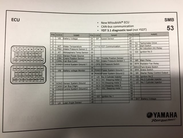

You guys get the use of the original YDS tool rather than the Cat made YDST. That's a good thing if based on past. Not sure if in manual but here is Diagnostic Codes from Tech Update Book.

This is actually the codes that YDS tool uses is many others also. Look at some of these.
Lean sensor angle. Is there a rollover shutoff? Sure looks like it
What is the radiator fan relay for?
Parking Brake Switch?

It's probably like the nytro. In diag mode you go to fan relay you can hit something and it will turn on the fan so you can check/trouble shoot it.This is actually the codes that YDS tool uses is many others also. Look at some of these.

My friend out riding today had a sr26 (?) pop up. Sled wouldn't pull over 80 or 7350RPM.

Same thing on except sd 26 on my buddy's.My friend out riding today had a sr26 (?) pop up. Sled wouldn't pull over 80 or 7350RPM.

Mine did same last weekend. Dealer called it as "Intake Sensor Code". Reading forums here found others with similar and that intake tubes were loose, so should be easy fix. Another item to watch that I also just learned on another TY forum was that the 2 bolts on the turbo seem to be loosening and must keep an eye on them and possibly need a lockwasher (Nordlock) or some sort of locking technique to rectify.
