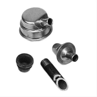

Has anyone else tried this?
Is this the kit you used?
STAIN
- Feb 29, 2004
- 4,341
- 3,608
- 1,713
- Vermont
- 2024 Arctic Cat Riot 9000
- Vermont
this also looks like an option
FleuryPerformance
- Feb 23, 2019
- 35
- 9
- 208
- Alma
- 2018 Yamaha Sidewinder MTX LE 50th
That’s an option I was looking for but never tried. Should work no problem IMO
