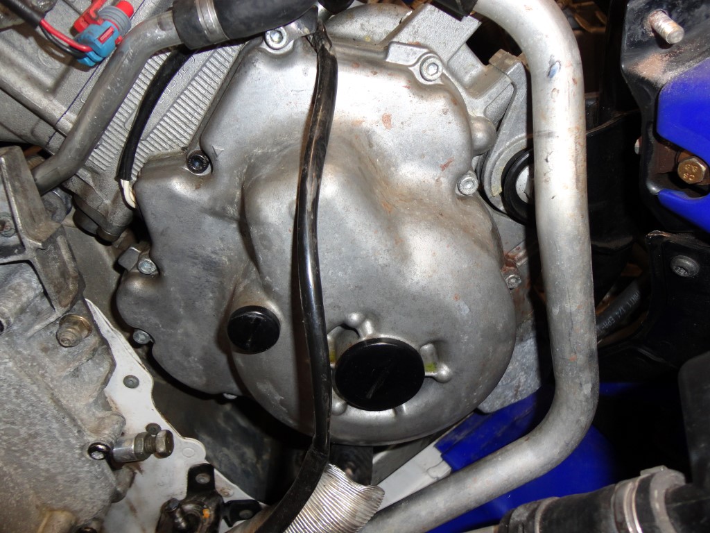

Step1 Modify Sidewinder Stator Harness to reach the Viper Pickup Coil plug. Use a scissor to cut the protective sleeve and separate the Pickup wires from the Stator wires. Then repair the sleeve over the stator wires and add a protective sleeve to the Pickup wires. The wires in Winder pickup plug need to be reversed in the plug. Use a pin to press tab inside and they come right out. Grey and white need to be in same spots in plug as Viper grey and white.Thats it.This allows you to plug Stator wire plug into the regulator since its identical and run the Pickup wires across to the existing plug on left side in Viper harness.
Black 2 wire plug on left side near steering pyramid above clutch cover. Plug With Green/White and Blue/White wires plugs right in.(The two white plugs in Pic are for my PCV Ignition Module)Male end of Black Plugs wont be used anymore but will stay till I know it all works.

Completed Harness. Will be run alongside the reverse actuator wires which have foil heat barrier (DEI AutoZone)so I did same. Then over engine to Pickup plug on left side. Plenty of wire and no cutting or splicing. SideWinder Harness is way nicer than our Viper wiring. This is in between. I am happy with it.

Checked fit of Sidewinder Cover. Perfect!

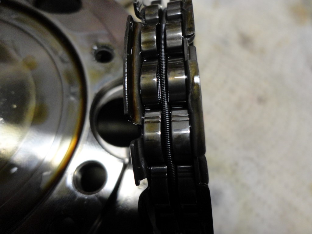

The infamous Idler gear. Perfect
Oneway bearing perfect
Fun stuff
