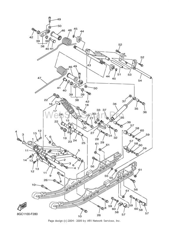

I figured I should post a quick update. I've attached a blow up of the skid assembly that I found online. It looks like you can just unbolt the front and back of the skid from the tunnel, collapse the skid itself and pull the skid out the side while leaving the track and drive shaft/wheels installed. Does that sound right to everyone?
I bought new hyfax today, and I'll probably pull the skid and install them tonight. I'll try to take some pictures and post them so that others looking for guidance on how to remove the skid will have more detail. I'll post what I find with the bottom link as well. I'm going to find out why my rear suspension sags 7" under it's own weight if it kills me!

Yes that is correct. You shouldn't even have to collapse the suspension. Just remove the front and rear bolts

Well, just got done pulling and re-installing the skid. If you have a second person helping you, it's pretty easy. However, I would recommend releasing the rear torsion springs and sliding them up and out of the way so you can collapse the rear of the skid. At least it seemed to make things much easier for me.
See the post about 'Phazer saggy butt' for a follow up on my rear suspension sag issues.
Anyhow, I was really writing just to report that pulling the skid isn't that bad so if you are thinking about installing hyfax (or any other maintenance that requires pulling the skid), you should have NO PROBLEM doing it yourself. I have to pull the skid back out for bushings and hyfax so I'll try to take pictures and post a small set of directions.
