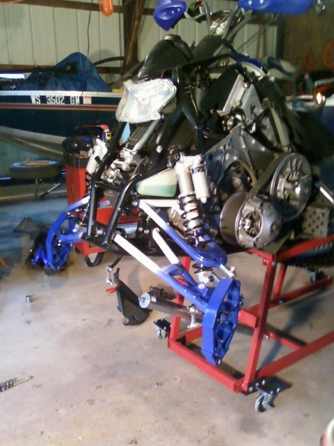

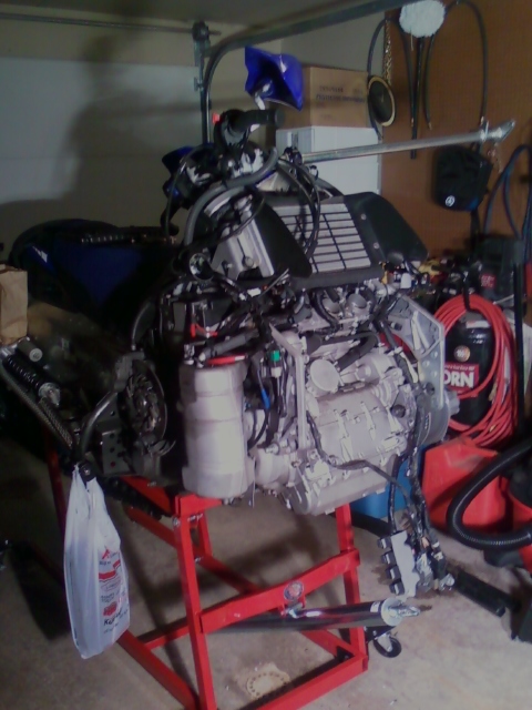

Just in front of the heat exchanger, it's a solid point and balances the sled on the lift. I have that lift form princess auto works great and is heavy duty.

No removal of anything. The cross bar in the front is wide enough to catch the frame on each side. Trying to attach a picture, but my smart phone is being stupid!
