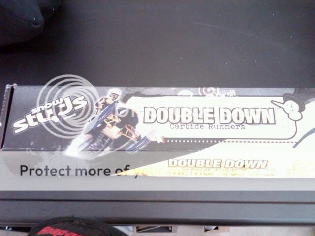

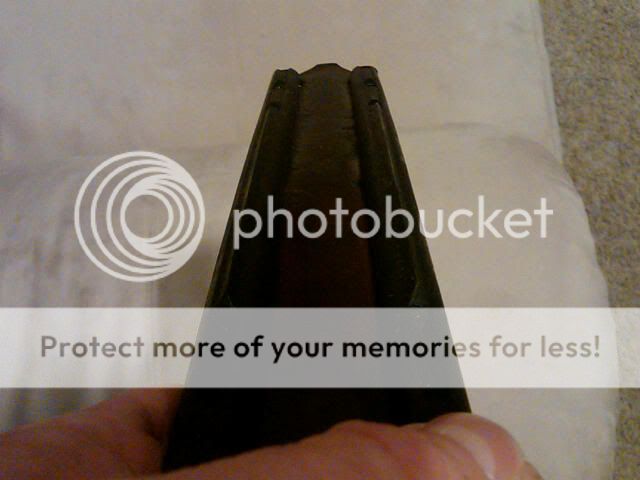

After going through 4 shaper bars I had enough of them and I needed a beefier carbide. I left a message for bergstrom and CB performance but they never called me back. I went to ebay and found the site johnmaster dot com and found they sell a dual carbide for the slydog ski from snow studs. I had never heard of these. I wasn't a huge fan of the woodies duals but I did like not darting and was ready to give up some push for 100% elimination of darting with these snow studs. We shall see what happens after tommorrow.

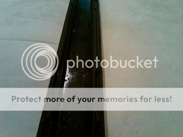

Old shaper bars all 4 looked like this! (click to enlarge)

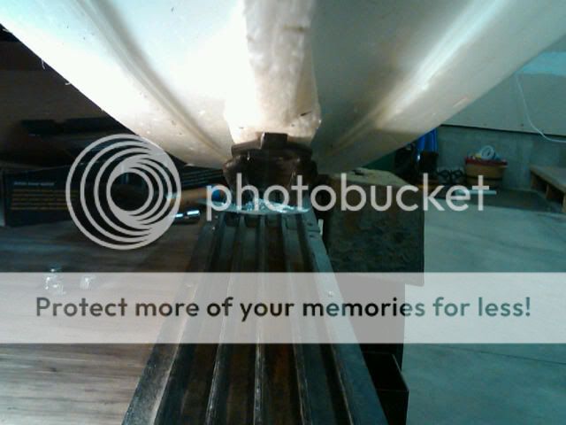

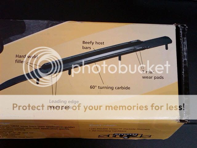

The snow studs have some unique features for the dual first, 1/2" host bars are BEEFY no bending here. 2nd they space the bars out 1.5" from each other so rocks, ice, snow, etc cant get in between and get stuck like I have had happen on woodies Dually's.
Last the 1/8" thick back plate is like having a ski saver all in one. Plus they were only $100 for the 6" duals.
The spacing is what I am most impressed with I think it will be a cross between a dual and a simmons ski with a medium increase in steering, but no pushing in corners.
I will post the ride review after I get back from tommorrows trip, which will be on ALL hardpack and dart prone conditons.

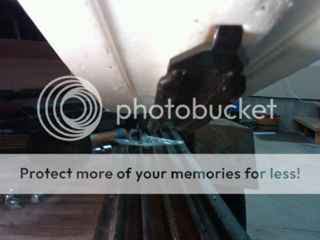

Just getting them installed I am impressed. Downside is they weigh about 3 times as much as the shaper but if they last so be it!

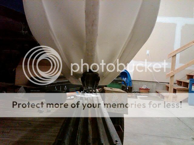

Pictures dont show it well but they come right flush to the same width as the keel of the slydogs and do not stick out past the keel like it sort of looks like in the picture. The white keel is hard to see. They looks like they were meant to be there in real life.

Interesting. I like the fact that you don't have to add a ski saver with these carbides. Too bad they don't extend right to the tip of the ski to protect that part of the keel - looks like that part of your keel is getting damaged wheras the outside of the ski ridges look good. I must say I have had the Studboys for two full seasons about 6000 Km and they are holding up good. Did your shaper bars sit right in the channel on the keel when installed with the ski savers or were they higher and more exposed to damage?

I do not understand why your stud boys look so bad. Dartless plates will give you the no darting and you wont lose penatration. You are now putting the weight of the sled on a wider keel.
I would also watch out for the studs breaking on those since your keel is curved, the flat part of the carbide is going to want to flex under it and might weaken the welds. I have installed a few sets of cat offset duallies(only duallies that seem to work) on yamaha skis. I run the grinder down them first to flaten the keel down so they wont rock.
