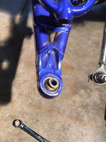

Hey guys,
Starting to do some fixes to get ready for this up coming season.. Starting with the most problematic issue is my bent spindle.. I was messing around with it but with no luck..
My main question is, is there a specific way of going about the removal of the spindle? I attached pictures and circled the ones I am unsure on how to properly remove with damaging.
Thanks for any assistance!
kallholmen
No, it's a straightforward job.
While you're at it, take a bit of material off from the upper ball joint. That's the best thing I've done for free on my Phazer. The negative camber makes a lot of difference for handling. Set it about -6 degrees (I have set mine a lot more but I've changed more stuff).

Thank you both for the information! As far as taking material off are you referring to the black that you highlighted on the ball joint?

Yes and yes.Thank you both for the information! As far as taking material off are you referring to the black that you highlighted on the ball joint?
As far as the spindle, I was going to try to get it straightened possibly if it doesn't work out though I would just get a used or new one. But the info on the Nytro ones makes a lot more sense! They would bolt on just like the originals?
Make sure that you lengthen the thread to. And then use shims or washers to get the camber that you like.
Will make at huge improvement!

Look where the little washers are.They need to be in there when put back together. Then pull it will come right off.

Thank you! I did just that and nearly pulled the sled right off the blocks it was on. Used a rubber mallet and got her off. It must have been pinched on there from me hitting the tree.

I will be taking my a arms off for powder coating as well and had a question of if people leave ball joint in? Or if you do take them out how do you do that?

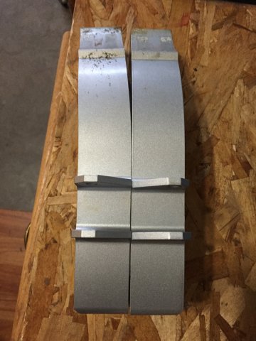

Also I attached a pic of the bent spindle next to the straight one. I'm pretty sure that it wouldn't be able to get straightened with a press or something?

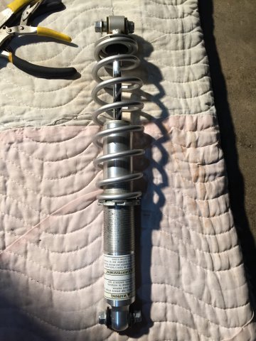

Another question I have is there any upgrade I can do to the front shocks? Or are they just the standard shock that isn't able to be upgraded or revalved.

Those shocks were only used on the 2007 Phazer GTs but are rebuildable. Don't know if they could be revalved.
I have almost 10,00km on my with out a rebuild so they seem to be dependable.

Unfortunately I can't say 100% for sure that the Nytro spindles will work, but my understanding is that there are a few minor differences but they would physically fit. From what I read on the JRE site, it also looked like they fit both Phazer and Nytro models. As far as powdercoating the A-arms, I would remove the ball joints and be sure to ask the powdercoater to mask the hole so it doesn't get all filled up. If I remember correctly, there should be a snap ring of some kind on the bottom side of the A-arm that holds the ball and 'cushions' or bearing material in place. I think Yamaha sells a rebuild kit for the A-arm ball joints as well, which would help to tighten up any play/movement you feel in the joints now, which (at least on my sled) feels significant by the time it gets up to the handlebars. Someday I'll get around to fixing it!

As far as the front shocks that sounds great! For this season I'll still run the ones I have but eventually upgrade them!
For the bent one do you guys think any chance of straightening it or just trash it?
