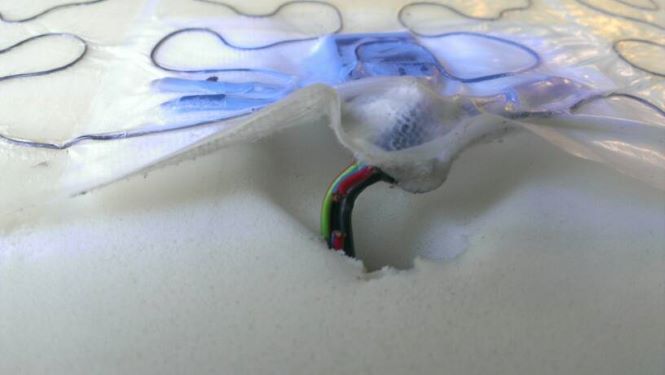

How hard is it to get the seat cover off to get to the elementJust keep in mind IF they (dealer) do nothing different other than install a new seat heater pad (or maybe fix a broken wire), it WILL fail again. Typically they last maybe 1-2 years. The wires flex pretty much right below the control chip and after flexing enough times as you bounce down the trail, one or more wires will break. Game over. So installing a new pad will make it work, at least until it breaks again. The "permanent" fix is to support the wires near the chip, and then change the factory wires to some super-flexible wire (available at McMaster Carr) which can flex millions of times and not break. It takes some work but it's the only way it will not happen again.
Turboflash
- Mar 18, 2019
- 2,951
- 2,955
- 1,183
- Southern MN
Not too bad. Just pull the staples from rear of seat going forward. Don't have to pull seat cover all the way off. Just pull staples far enough up so you can get to pad. Of course, that means you need a good staple gun (can get at any good hardware store) and some stainless staples to put it back on. Just take your time, it's not rocket science. You can see how far up I removed staples in this pic. Just roll seat cover up out of way. You can also see where the hole in the foam is where the wires go through and the pocket in the foam where the control chip sits.
The design error is that the wires flex right there and eventually break (one or more). So I changed where they flex and what is flexing. Can't have them flexing right at control chip where they turn down into hole in foam. Will break every time after a while. Prevent them from flexing there and change factory lead wire (which is junk) to some really good wire (that's made for flexing without breaking - (Continuous-Flex Wire, https://www.mcmaster.com/catalog/126/908).
