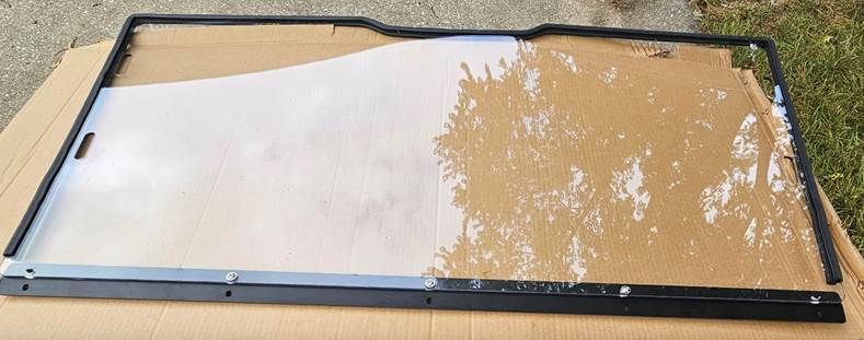

As the sticker indicates, test fit the windshield before taking off the protective films.
Install the rubber waterproof seal around the windshield.
Install three M6 screws and lock nuts in the three middle holes on the top of the windshield. The icon bar goes on the backside of the windshield as seen above.

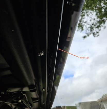

When placing the top of windshield into location, the icon bar is place behind the Roof Lip. The windshield is not placed in the groove of the roof. See picture above and below.

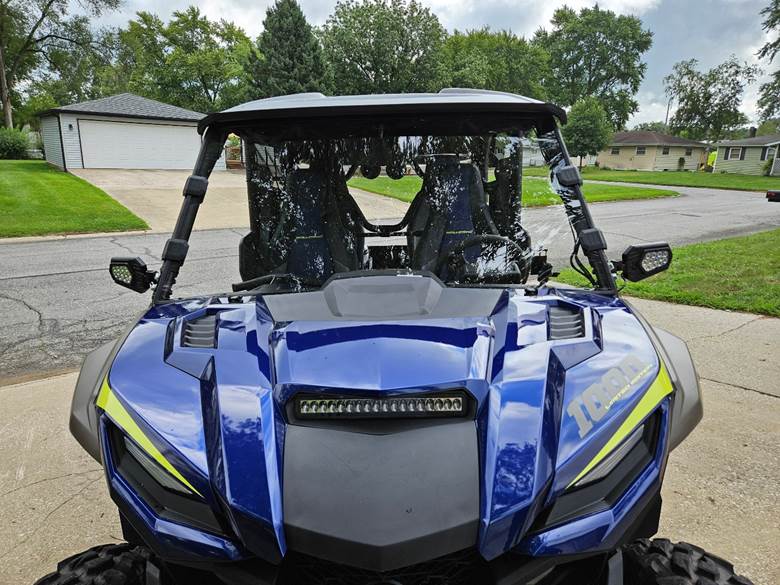

Once the other side is done, make your adjustments if needed for the placement of your windshield and perform final tighten.

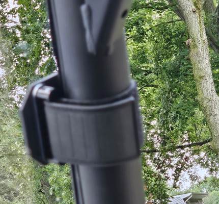

Last step is to install the four windshield clamps. Place the insert through the hole in the windshield. Feed the Velcro strap thru the insert and pull tight. Do this for the remaining three windshield clamps.
Completed
