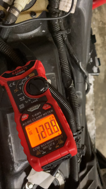

wats the easiest way to do this? suppose there is some right ups on it. tested my battery draw last night it was goodGood call on the booster pack. Unfortunate but necessary once in a while when owning a 4 stroke in the deep cold. I purchased my starter from a local supplier (Royal Distributing # 11-190743). I believe it was around $100. Before you purchase the starter, I would check the amp draw when you turn it over.

There might be, but just in case I did a quick test. I popped of the seat and put the amp clamp around the main wire headed to the solenoid. Spikes for a moment then sits around 120-130 amps while cranking. This is at ~20F. Let me know what you get.wats the easiest way to do this? suppose there is some right ups on it. tested my battery draw last night it was good
