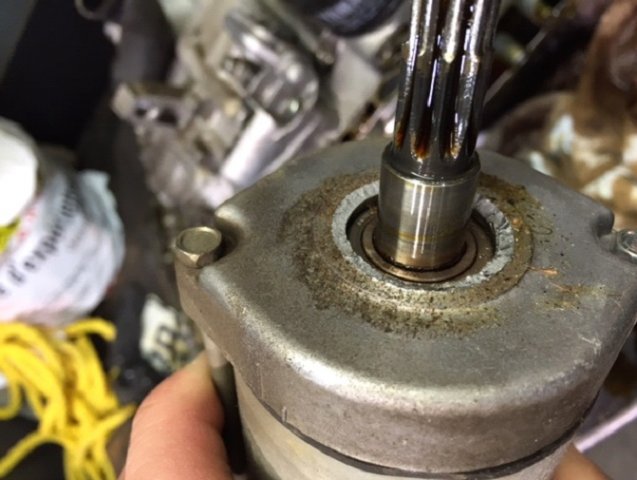

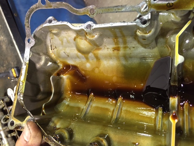

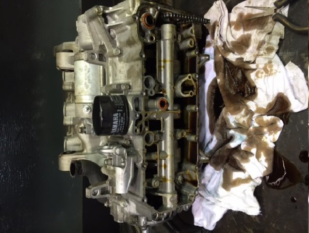

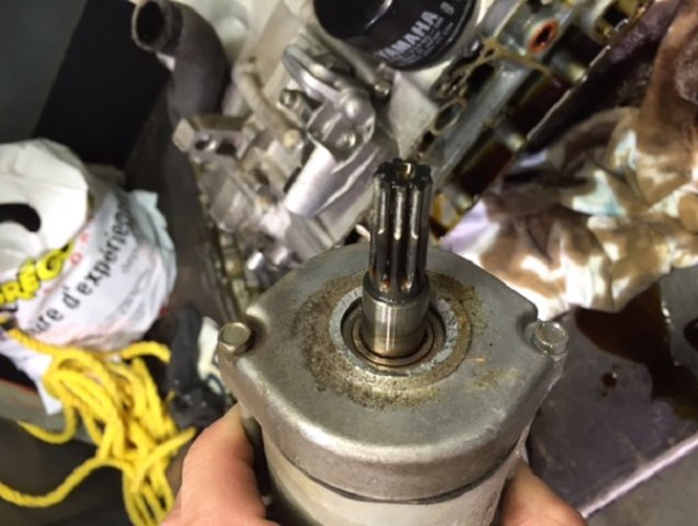

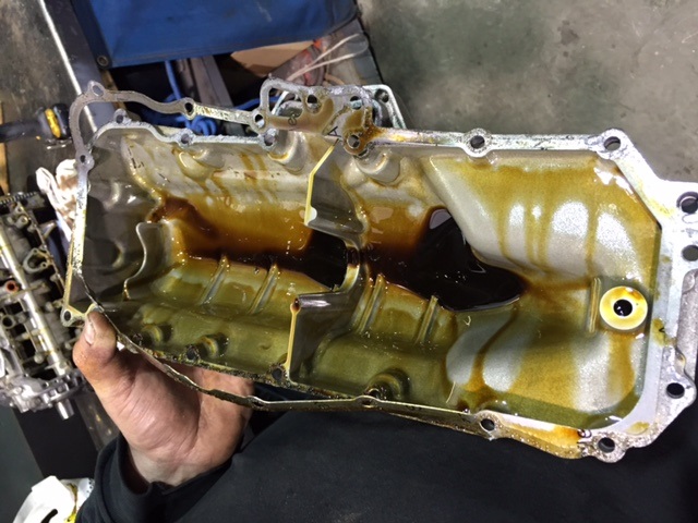

I have pic that the dealer took and there has to be 4 or 5 pieces of metal in the base. I just have to figure out how to post them.
Attacker
If anybody wants to post them for me. I will be glad to email or text them to u.I have pic that the dealer took and there has to be 4 or 5 pieces of metal in the base. I just have to figure out how to post them.
Attacker
They r on the way from my girlfriends phone thank you.Send them over
Thank You. Eye opening. Was planning on just going through side and leaving pan on if it happened to me. Not anymore. You have a wonderful mechanic. He did the right thing. Is no doubt now that it all needs to come apart. Including oil pump. Lucky it didnt shear the drive pin on gerator.

Looks just like mine did... ouch.

You r right the service and mechanics at gregoires r great. They had me back up and running in 4days. I had the last ride on this machine yesterday will probably trade her in with a happy 11000 miles. Thanks for sharing the pics for me Carbondale.Thank You. Eye opening. Was planning on just going through side and leaving pan on if it happened to me. Not anymore. You have a wonderful mechanic. He did the right thing. Is no doubt now that it all needs to come apart. Including oil pump. Lucky it didnt shear the drive pin on gerator.
