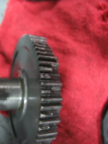

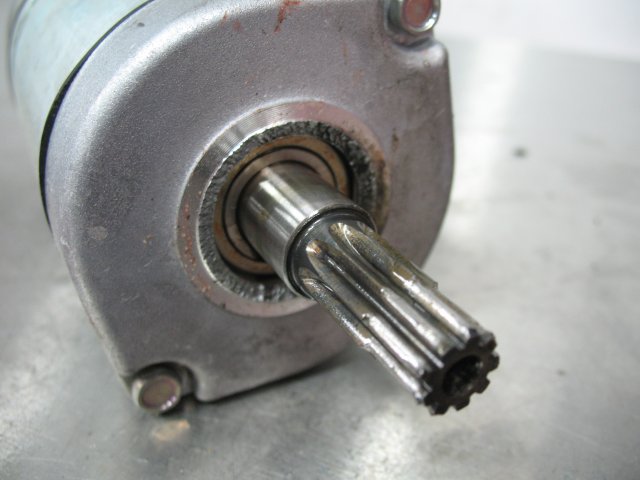

Looks a lot like mine did but I didn't loose that many teeth on the gear.Here are photos of my latest starter. The end of the case is broken and there are gear teeth missing on all gears. This is different from my first starter failure. That one had shattered magnets. View attachment 113396 View attachment 113397

All I can say after this happened is to pull starter if you hear any grinding noise when starting. I think the nose breaks on the starter first and the rest is damage done from starting with nose broke.

I believe that is absolutely true.All I can say after this happened is to pull starter if you hear any grinding noise when starting. I think the nose breaks on the starter first and the rest is damage done from starting with nose broke.
Backfire before blow or not?

There was a period of time when the starter sounded bad but wasn't grinding. I believe that is when that nose is coming apart.All I can say after this happened is to pull starter if you hear any grinding noise when starting. I think the nose breaks on the starter first and the rest is damage done from starting with nose broke.

Me too. Knew it was happening but wanted to get last ride in.

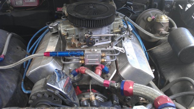

Had this backfire and break the starter case in half so yeah kickbacks can be very damaging

Just curious why you have the carb mounted that way?Had this backfire and break the starter case in half so yeah kickbacks can be very damaging
