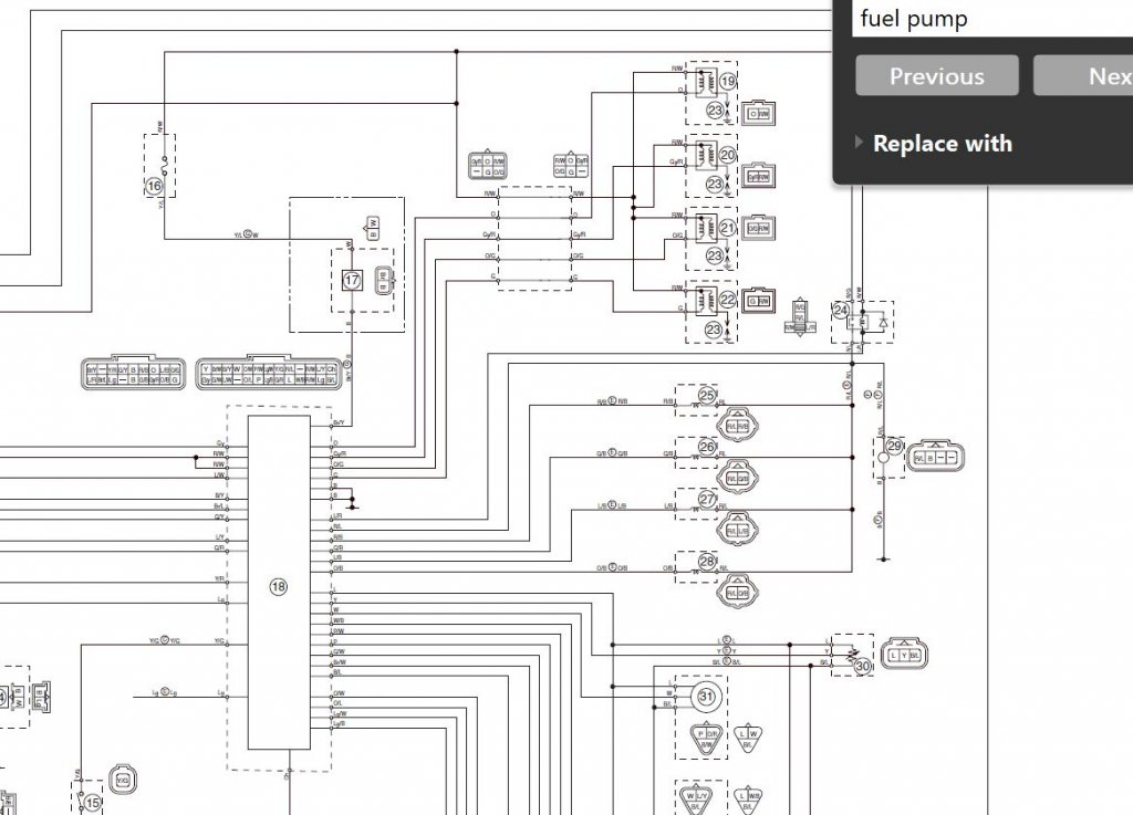

I have a few more minutes to help now. Go back to the basics; (as if it is carbureted). Spark, Air, Fuel, timing. (assuming you have compression). Since you are not getting backfiring or the motor trying to catch, I would still suspect fuel, especially if you don't hear the fuel pump when the key is turned on. The attached wiring diagram shows 24 as the fuel injection relay, 25,26,27,28 as the fuel injectors, and 29 as the fuel pump. Note that the fuel relay drives the whole fuel system.
I would make sure that with the key on, I am getting 12v at the fuel pump. If no fuel, check the output side of your relays. A fast check is to just swap a known good relay with the fuel pump relay. Barring that, you could temporarily jump 12v to the output wire from the relay (remove the relay) and that should provide power to the injectors and the fuel pump.
Then its back to spark, air, timing.

Yeah the dealer gave me that diagram. I've tried pretty much everything that has been posted on the site. That's why I got to wonder about the bigger stuff like stater or crank sensor. What about a cdi box? Every thing relay on is replaced and still same result. All fuses replaced as well. It just acts like the computer isn't communicating with the rest of the sled.
