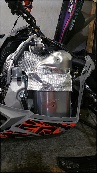

Just thought I would post up a pic of my exhaust setup. I know some states and provinces like to hand out tickets if the exhaust is aftermarket regardless of sound levels. I have never been harassed with my previous turbo cats...but when I changed this one out I figured I would go the extra step just in case. This is a Sandale 3" Hyperflow exhaust. I removed the heat shield from the stock exhaust, modified it slightly, and reinstalled over the hyperflow. I then put the turbo heat shield back in place. To the untrained eye I would say it looks box stock. I took it out for the first time today just to see what it sounds like. It is definitely louder than stock (which is whisper quiet) but it is no where near obnoxious. It's a very deep tone, and sounds great.

Only flashed sled and installed exhaust yesterday. Will be riding all weekend. I'll try and get a buddy to film sled so you can hear it. But probably won't be able post it till after the weekend.

Quick question: Did your TD Superquiet include a bracket to bolt up the heat shield? It looks like you were able to bolt the heat shield back on but from what I've found online (and please correct me if I'm wrong here) the only aftermarket mufflers with the bracket are Precision EFI and Hurricane. Not a huge thing but suspicious if checked and those two holes don't have bolts in them and my OCD would get the better of me on this one. Thanks in advance! Exhausted from exhaust shopping...

my guess is you would have to trim the backside of the oem heat shields slightly...

I welded the brackets from the stock muffler to the new one. So the shield would fit just like it did from the factory

Be warned that putting the stock shield and the insulation mat together keeps too much heat and muffler life is reduced quite a bit.
Best is to just install the shield no insulation.
The shields fit over our TD surperquiet exhaust
http://turbodynamics.mybigcommerce....-thundercat-sidewinder-zr9000-2017-2018-2019/
and the viney fab 3 inch tru muffler we sell. The viney fab is made for us and looks like our super quiet but 3 inch.
http://turbodynamics.mybigcommerce....r-998-turbo-sidewinder-srx-thundercat-zr9000/

Do you have sound clips comparing the 2.5" vs 3"? I'm assuming 3" a little deeper sound, somewhere between your SQ and TF?
Does the 3" flow that much better? What's the biggest difference? More power, quicker spool/better response, better sound?
